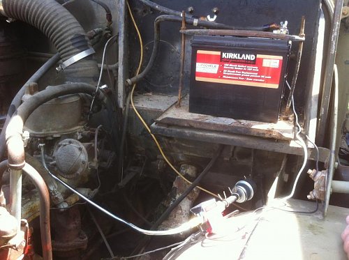

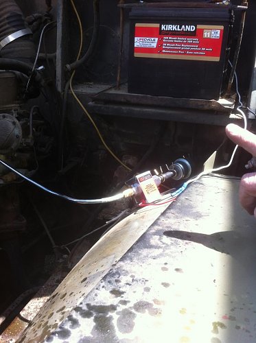

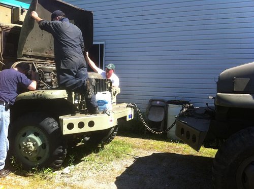

ID:	65854After sitting for over 8 years, we got my M-220 running today. Drawing fuel direct from a Jerry can mounted on the step, then through an inline filter and to the carb. Purrs like a very large kitten.

Here are a couple of the shots Of the rigging Dave did for the fuel feed. Will be carrying extra can if we venture more than 50 feet from the shop.
