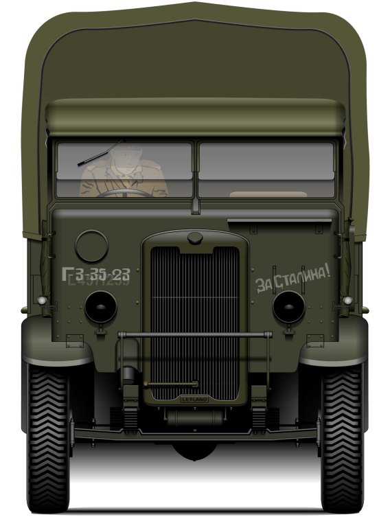

Old 17-11-04, 02:18
Oliver Missing's Avatar
Oliver Missing Oliver Missing is offline
Join Date: Nov 2003
Location: Germany
Posts: 58
Default Russian Retriever
Oliver [http://www.o5m6.de].
Old 17-11-04, 10:13
Oliver,
Great! How many time did you spend on this one?
I hope to build one as a scale model in the future.
