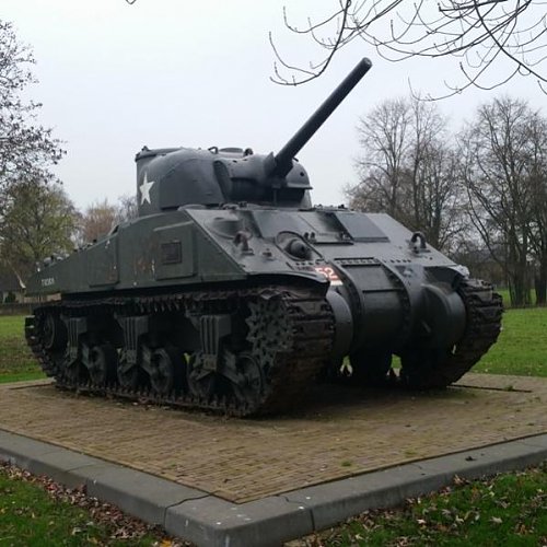

Hereby a photo for your collection.
This is an ex Fort Garry Horse M4A4 Sherman.
It is on static display in the town of Doetinchem, Holland.
FGH liberated Doetinchem and the relations between the Regiment and the city are still very alive!
This particular Sherman took part in the liberation of Doetinchem on April 1st 1945.
On April 12th 1945, it was hit by a panzerfaust on top of the the turret near the city of Hooghalen, killing the commander (Cpl Mc Donald) and one man wounded.
Very shortly after the war, this Sherman was collected from the Hooghalen area and put on static display in Doetinchem, so it is there for 60 years now.
You can still clearly see were the panzerfaust hit the turret.
The fact that this Sherman was Cpl McDonalds tank has always been known.
10 years ago, we were participating with another Sherman tank in a celebration in Nijverdal, and one of the FGH veterans on our turret was wearing a gold decoration clearly showing the city name "Hooghalen",
So I asked about the details of this decoration and (hardly to believe), this man was the the gunner in Cpl Mc Donalds tank and also the man who got wounded on April 12th.
The gunner, Peter Siemens, was very much surprised when we told him his tank was still on display in Holland.

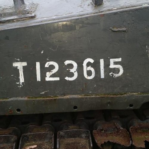

As far as I know, the number "T-123615" is the original one.
Marco

The memorial tank pictured in Doetinchem is currently wearing an incorrect Census Number.
The number should be T232615.
When the tank was last re-painted by the local community, in 1995, our museum sent samples of the size and style of lettering to be used. Unfortunately, the painters interpreted the string of sample numbers as the actual number.
This Sherman V was selected from returned stock in October 1945 to be used as a memorial. Marco is correct on the details of the crew and battle damage.
It was cleaned up and painted by the FGH while stationed in Doetinchem and presented to the town on 25 November 1945, shortly before the unit left for Canada.
In August of 1965, members of the FGH (Regular) built a new concrete base for the tank and moved it into a more prominent position in the park, where it still stands. At that time a plaque was added to the side, and a bronze regimental Gate and Scroll (now missing) to the transmission cover.
The 1965 repaint retained the correct census number, but had a mix of wartime and 1960s era insignia.
The 1995 repaint is correct except for the number, though the stars (added for appearance) are unlikely for the 1945 period.
Gord Crossley

Originally Posted by gcrossley View Post
The memorial tank pictured in Doetinchem is currently wearing an incorrect Census Number. The number should be T232615.
This is how the FGH Sherman stands today. As anyone can see, it is in dire need of a revamp. Planning is underway to repaint it for the 70th anniversary of the liberation of the Netherlands in April next year.
Gord, could you please send me details on the correct markings? I will pass them on to the local members of Keep Them Rolling who will take the refurbishment in hand.

The FGH Sherman tank in Doetinchem has been cleaned and repainted last weeks. The last thing to do is to apply the FGH markings.
To do that correctly, there are some questions:
Reading the "Vanguard" , I mean to understand that T232615 was in B-squadron. Am I correct in this?
Is the troop number from Cpl Mc Donalds troop known and if so, should it be shown in the squadron marking on the tank?
Marco
Old 23-03-15, 00:22
gcrossley's Avatar
gcrossley gcrossley is offline
Location: Winnipeg MB
Posts: 41
Default FGH B Sqn tank in Doetinchem
T232615 was in fact a "B" Squadron tank, part of 3rd Troop, led by Lt. Holmes. It was hit in the top of the turret by a panzerfaust near Hooghalen on 12 April 1945, killing Cpl MacDonald.
By April of 1945, Squadron markings only appear on the back of the tank, as a yellow square, with the centre of the square apparrently painted black. A good example of this can be seen here. http://www.canadaatwar.ca/photo/39/the-netherlands/
As mentioned earlier the turret stars would be very unlikely for this period, but he large circled air recognition star on the turret would likely be present.
There is no photographic evidence showing troop numbers on the tanks in the later part of the war. Many FGH tanks in photos from that period carry few markings beyond the census number, and unit serial flash and 2CAB decal on the rear.
Gord Crossley
