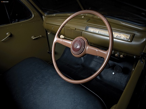

Some photos via favcars dot com; looks like they got them from the RM Sotheby's auction catalogue. These are the only photo's I could find back on the internet, I am pretty sure at the time of auction there were many more on the RM Sotheby's auction site.

Ian McCallum wrote: "thought it may be the Nick Alexander example on seeing the wheels. Can't recollect any photos showing the underside but one of the dash did not show any auxiliary switches or data plate. Would have been nice to have known its history prior to restoration. The Nick Alexander’s dash, no auxiliary switches or data plate above speedo, as fitted to all contract ADF’s and AS’s and see on mine."

Ian McCallum noted “interesting in looking at the Chassis numbers I have managed to collect, including my own, they all follow the same sequence of 2D-xxxx-F which is completely different from that shown in the Auction details.”
So I get the impression this Station Wagon was not a C11ADF originally
