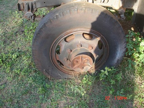

Default Truck appears to have 20"
Hi Dave
That is correct C15A should have 16" but this one appears to have the brakes and drums incorrect rims of 20".
Photo shows what he is working with

Old 07-02-15, 03:55
Those are regular 3 ton wheels for duals. Has the rear end been changed or just the hubs? I got an email from him too but I only have the one C15A. If it was a Ford I'd have lots of parts.
The hubs don't need changing, 8 stud Bedford rims are the same paten as CMP.

I can't be 100% certain from the photo; however, the brake drums appear to be the smaller C15A drums vs. C60 based on the clearance to the wheel and the width of the drum. As a result the owner would have the option of running 16" or 20" wheels depending on their preference. It would appear that someone opted to utilize different wheels at some point in the trucks history. Other than the wheels everything else looks stock to me.

Normally you would have a shifter for high range and low range and 4x4 wheel and 2 wheel drive.
I believe you truck is set up for High range 2 wheel drive and when you shift to 4 wheel drive you are automatically shifting in low range.
I also notice that you do not have an emergency brake system at the back on your transfer case.... the bracket is there but the brake system has been removed.
Do you have pictures of the inside of your truck.... the engine cover should have a plate indicating the shifting pattern..... would like to see the shifting levers you have.
Bob C

Default Picture interior cab
Bod,
I send the original picture the interior cab, when I localized the truck.
deposito #1 016.jpg   deposito #1 017.jpg   deposito #1 018.jpg   DSC04195.jpg   DSC04196.jpg
Joćo Bosco Barbosa
1944 Chevrolet C-15A
Sćo Paulo - Brazil
Old 12-02-15, 04:40
Posts: 5,261
Default Good pictures....
Hi JoaoBosco
Looks tired but very original.
The engine looks like an original 216 Chevrolet engine.
The picture of the shift levers.
The top one with the round knob and funny bent shaft is for the transfer case and probably only moves forward for low range and back for hi range.
The second lever is for the 4 speed tranny with the lock lever for the reverse.
The third lever is partially obscured but should move forward to engage the starter motor.
The fourth lever is very strange....... I beleive that is connected to the front axle and moving forward would engage the front axle....moving backward would dis-engage the front axle for 2 wheel drive. It has a lock lever on it which is not normal.
This set up is not original BUT if it works you may want to keep it for now.
Is the engine turning free or is it stuck solid????
When was the last time the engine ran or worked??
You have a lot of work ahead of you my brother/hermanos.
Bob C.
