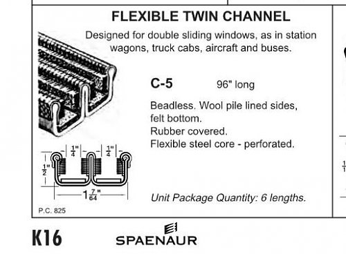

Posts: 14,934
Are you referring to the the metal flex core, twin channel felt covered item the two sliding metal panels mount into? SPAE NAUR used to carry it in their antique auto section of their catalogue.
David,
That's what I am looking for, indeed.
I looked up their catalogue and found "Flexible Twin Channel C5" on this page: http://www.spaenaur.com/catalog/#K15 I this the item you refer to?
Name:	Spaenaur flexible Twin Channel C5.JPG
Thanks,

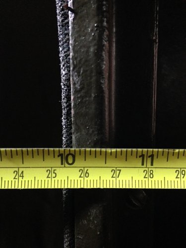

Old 21-06-15, 22:42
Posts: 14,934
Joćo,
I measured up the channel in my truck, and while it is approx. 1/2" high, the width less than an inch (approx. 7/8"), rather than the 1-7/64" (or 1.11") as per the picture in the catalog.
Now, the channel in my cab window is too narrow as the steel sliding plates can only be moved with much force (can't say they are "sliding", really).
But I do not know if the width of the SPAENAUR twin channel will fit the frame.
Who has tackled this job before and can help?!?
