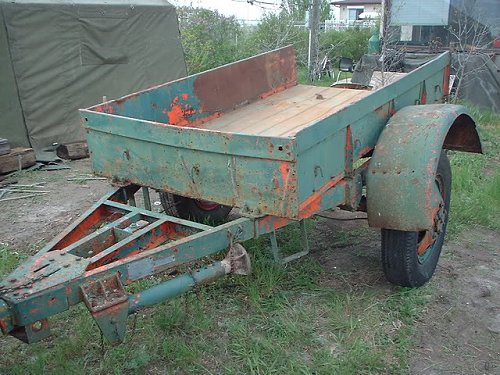

Posts: 7,623
I have the remains of one of those bodies. It is relatively rust free but they cut the sides to make it narrower. Metal is all solid. I use it for my scrap metal bin...I can take some photos next time I empty the scrap. Floor was solid as I recall.

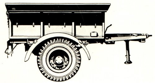

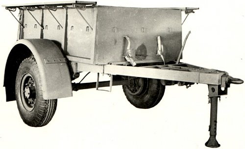

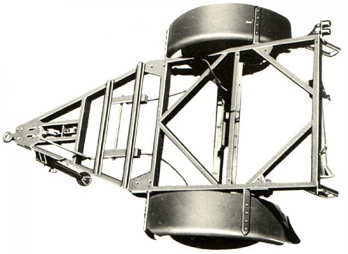

Photos from the AEDB record attached to provide comparison to what I have.
Name:	AEDB 15 cwt chassis.jpg
ID:	75258 Click image for larger version
Name:	AEDB 15 cwt front right.jpg
ID:	75259 Click image for larger version
Name:	AEDB 15 cwt side.jpg

Here is a shot of mine back when I dragged it home.

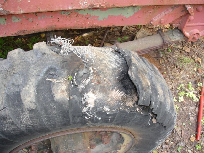

As part of the process to register the trailer for road use (trying to be legal and register promptly rather than waiting for work to be completed) the trailer was taken to a local weigh scale to be weighed (Ontario wants a statement of weight if 900kg or over for a manufactured trailer or for any "homebuilt" trailer). I was expecting the empty trailer to be close to 900kg and that is what the scale said.
I had decided to use the original tires and as we set out, it became clear that one was severely flat spotted from sitting. 20km/hr to limit the bouncing, shaking and wobbling. The attached photo is the result of 14 km at the low speed without load. I had been planning to replace the tires, now I won't have a choice.
