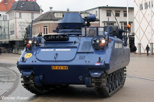

Oh yes, the MoD can of course drive tracked vehicles over the road, but only in a convoy. But possibly the Military Police do not to have to drive their YPR765's in convoy?
Knowing the Germans, and as close neighbours do, they would probably file for a convoy to notify us of their advance
