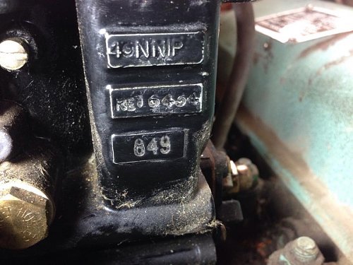

The numbers on the carb are as follows
40NNIP
RE16434
849

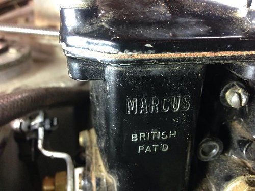

The other side has
Marcus
British
Pat'd

Thanks Steve,
40NNIP is correct type, the only specification number I have is the Solex one, which Marcus would use as well, that is S1682 for a Ferret. The RE number is a Rolls Royce stock number. Those carbs used on 8 cyl engines could be considered identical, but I believe jet sizes differ. Will have a delve later on and let you know sizes for a Ferret.

The two carbs stamped RE16434 had 22747 and 19195 stamped underneath.
Two other Ferret 40NNIP carbs I worked on were stamped RE14549. They had 5537 and 6264 stamped underneath.
I have to think these are serial numbers, so Solex made a lot more RE16434's than RE14549's? I didn't notice any difference between the two RE #'s.
These were all Solex carbs, with no sign of the "Marcus" designation Steve refers to. What is that? Did Marcus make Solex carbs? Is that why the "849" number is so low relative to the above numbers?
FYI, as you can see from the 40NNIP number in the photo below, the 40 and the NNIP were cast into the carb body, and the 0 was stamped.
Malcolm
Malcolm,
Marcus Engineering took over the manufacture of these carburettors in later years. It was they that resolved the inherent problem with the 48NNIP carb fitted to the CVR(W) Fox, with a redesigned base plate and accelerator pump linkage. Nearly too late as the Fox was near the point of being withdrawn.

My carb.......
Attachment 78284
Steve

carb 2
