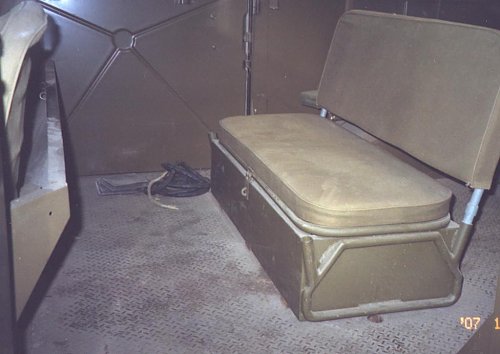

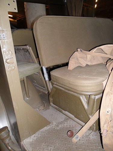

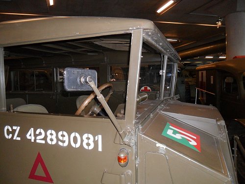

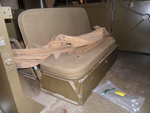

James, are these pictures of any help?
They are courtesy of Don Allen's photobucket page where you can find many more C8A HUP pictures.
I last saw this C8A in The Netherlands decades ago when it was unrestored and unmolested. Its former owner, Marien Goud, expertly restored it and then sold it to the Canadian War Museum.
