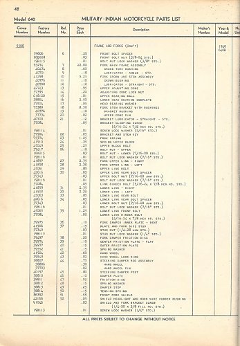

Would you be able to post a shot of the front forks diagram from the parts manual Lex? The front forks were taken apart and some of the hardware lost. That is one of the areas I am trying to re-assemble.
And of course, I am looking for a parts diagram or closeup of the axle stub on the sidecar. I am missing some form of spacer/retainer on the outer portion.

There are very clear diagrams on that website Rob, but will look in the manual later.
This one here should be the right one;
https://www.jerrygreersengineering.c...42&m=Spt_Scout

Well, while I'm behind the computer, might aswell do it now:
and
Hope this is clear enough? they are big scans, so hope it works,
Lex

Thanks for the posts and links. When I hit the photos though, they take me to the G503 website where I need a password to view your album.
I saved the photos to my computer and they expand reasonably well. I also already have saved the photo from Gerry Greer's site as it was the closest I could find to what I have here. There seems to be a variation to the two upper shackle bolts on this bike. Rather than a bolt, this one has a long rod that is threaded for a short bit on one end, and a longer length on the other end, which will be for the one threaded shackle. I made the jam nuts, but I guess my main query was on the size and quantity of spacers and or thrust washers. I see there are no thrust washers used, but two spacers at the rear upper shackle bolt (or rod in my case).
Or does it? Your parts diagram shows item #34 (pn 42616) spacer as being on the forward bolt, but then lists it as belonging to the lower link. Because the manual does not offer the quantity used per equipment, it is hard to determine if the bike just uses two or 4 of these.
I am certainly closer to assembling this correctly than I was before, so thank you.

Between your scans and the scans on Jerry Greer's site, I think I have it. His site is especially valuable since he gives a lot of dimensions of each part as well. My two "rods" may have just been a production convenience. Far easier (and cheaper) to make a long rod threaded on the ends than to make a long hex headed bolt.
I see he has a reprint of the manual for the 640 with serial numbers just ending before the Canadian numbers. I'll get that ordered this week.
