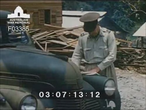

Some colour footage of staff car ...near the end . Appears to be green\black
https://www.awm.gov.au/collection/F03385/
Well spotted Mike, thanks for posting. I've seen 8th Div camo before but never in colour.
Expected scheme would be Khaki Green No.3 (Australian production) with disruptive colour Dark Tarmac No.4 (standard British disruptive colour at the time) applied in Malaya.

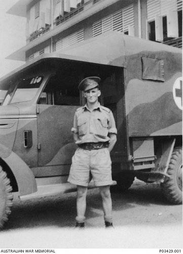

Name:	P03429.001  Malaya   1941  Chevrolet 30 cwt Indian Army Pattern Ambulance donated by Rawleighs L.JPG

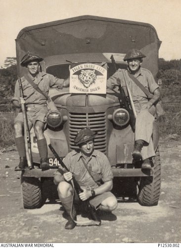

Name:	P12530.002  Malaya  c. Dec 1941  men of HQ 8th Div pose in front of 1940 Chev truck (note camo).jpg

The Dark Tarmac , it appears to be sprayed on because the edges are not well defined . It may be a optical illusion caused by the poor resolution of the film but if it was brush painted there would or should be a sharp well defined edge where the two colours merge. The Emu is well defined .
Is the car a Chevy ? 1941 model.
I agree Mike, definitely spray painted. Edges were supposed to be brush painted, as seen on other examples. This was later stipulated in Jan '42 directive: "All edges are to be kept sharp, it may be necessary to paint the boundary between two colours to obtain sharp definition."

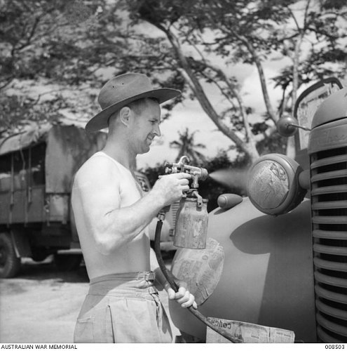

It's possible the whole car was resprayed at the time, eg: AWM 008503. MALAYA, 1941-07. AN ARMY LORRY GETS A COAT OF CAMOUFLAGE.
Name:	008503  MALAYA, 1941-07. AN ARMY LORRY GETS A COAT OF CAMOUFLAGE..JPG
Definitely Chev but looks like 1940 model to me. I'm no Chev expert though!
