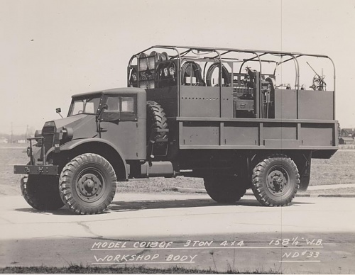

P.140 of the AEDB Design Record Vol.VI:
Name:	Technical vehicles - p.140.jpg
Cab 12 Pattern Ford F60L Workshop, Canadian factory photo. I don’t know which machinery type it is.
