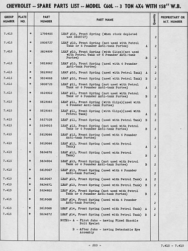

Default Which Pattern ?
Hi John

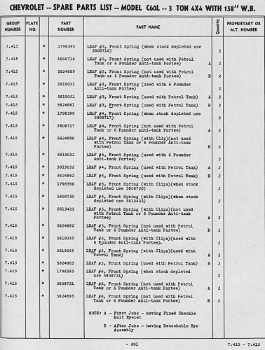

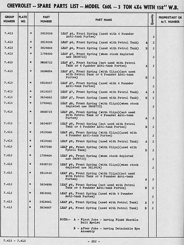

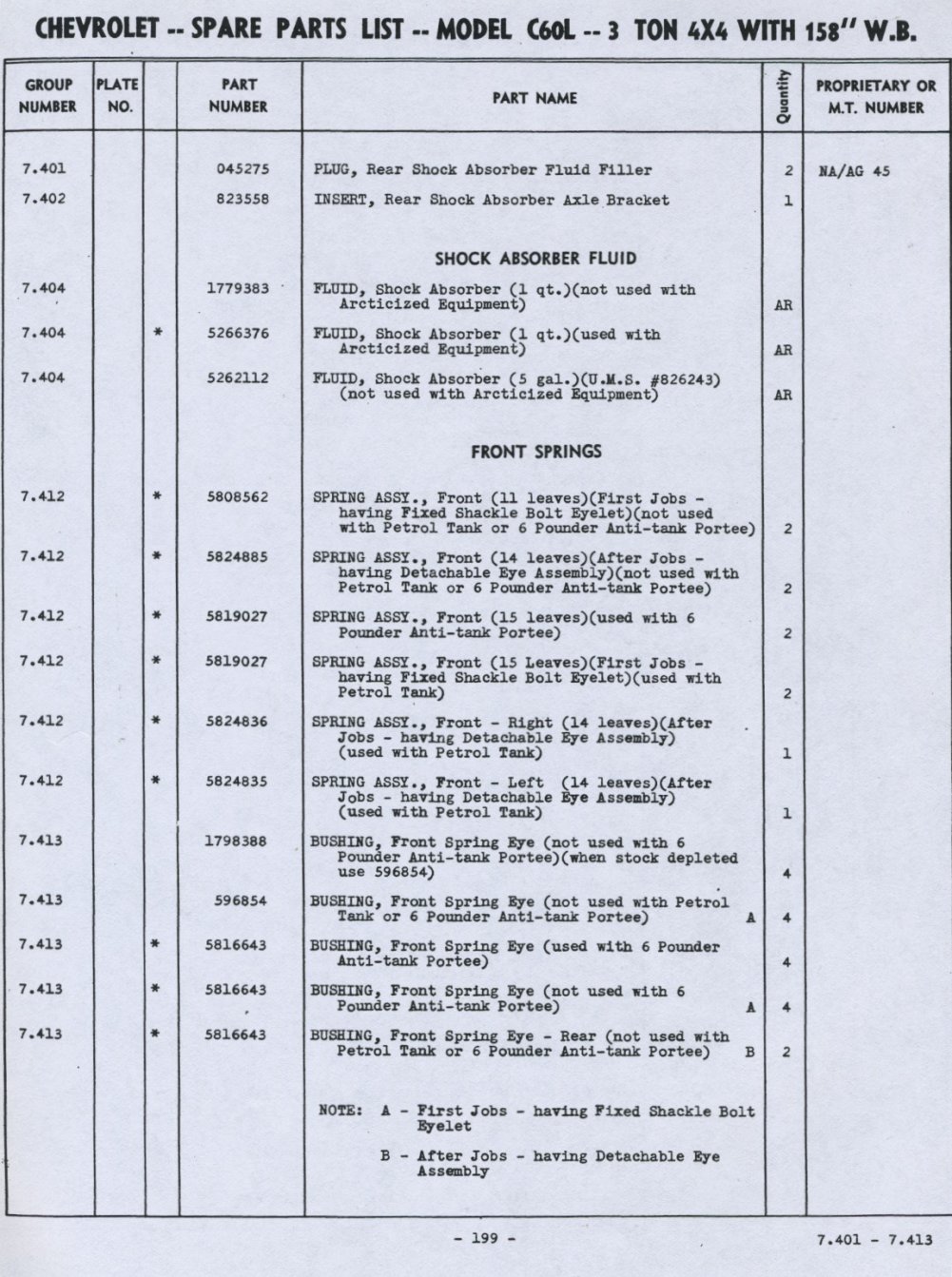

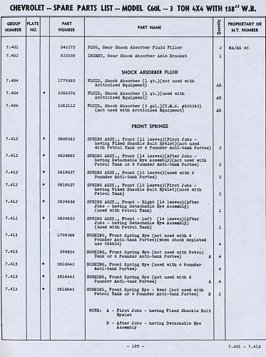

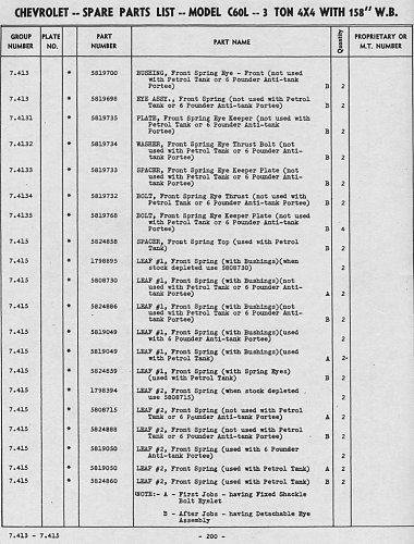

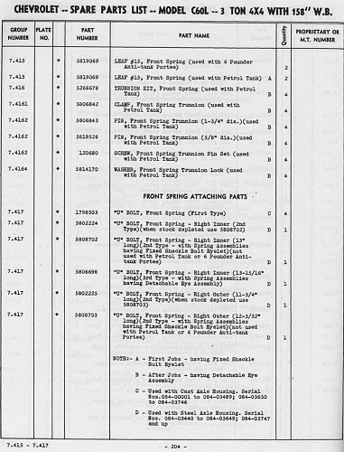

Have the C60L 1944 Parts book, looking at the spring listing it appears that there is a difference between First Job (generally Pattern 11-12) and After (generally Pattern 13) So which is your truck?
If it is of any help here are the spring pages
Name:	C60L Parts Springs.jpg
Name:	C60L Parts Springs 1.jpg
Name:	C60L Parts Springs 2.jpg
Name:	C60L Parts Springs 3.jpg
Name:	C60L Parts Springs 4.jpg
Old 03-10-16, 22:18
Default Last page
Name:	C60L Parts Springs 5.jpg
PS- If your source has any luck working from these or any other CMP parts numbers hope you will share the source. Also if they have spring dimension see if they would be willing to share that rare data with the whole CMP community.
