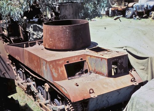

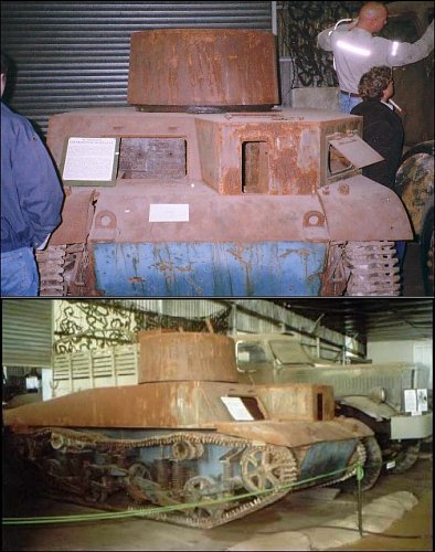

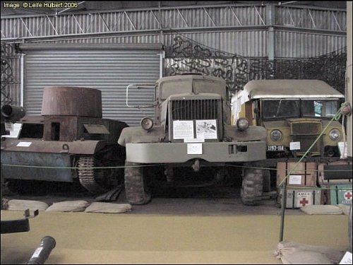

Try these photos, I think it is the one you are referring to.

Regards Rick.
