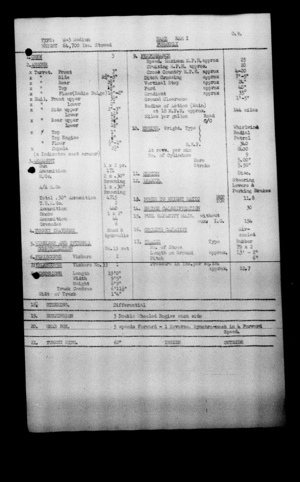

Anyone with the manual could you tell us if they list any general specifications?
even if it's just weight, but if they included some armour measurements or dimensions that would be great.
Spec sheet lists the following for example on armour.
Turret front 76.2 (I suspect they mean the cover plate, and not the internal mantlet)
Turret sides 76.2 - 69.85
Turret rear 63.5
Turret top 38.1
Turret floor 50.8 - 38.1
(radio bulge)
Hull front upper 88.9
Hull front lower 50.8
Hull sides upper 76.2 - 50.8
Hull sides lower 38.1
Hull rear upper 31.75 or 38.1 (hard to tell if it's a 1" 1/4 or 1" 1/2)
Hull rear lower 38.1
Hull top 25.4
Hull top engine 12.7
Hull floor 25.4 - 12.7
Cupola 63.5

The data book does though - this may help.
and dimensions

Thanks Lauren
Interesting... Values are all over the place depending on source. The top armour values from some sources are confusing, 76.2mm is extremely thick for a hull roof, unless they are counting the curving hull top in front of the turret, areas around the cupola etc and they are the higher values.
Examples
Hunnicutt
Hull
Upper front 76.2 - 50.8
Lower front 50.8
Sides 63.5 - 31.75
Rear 38.1
Top 25.4
Floor 25.4 - 12.7

Files came today, some lovely photos.
No actual thickness values are given for the turret front in the test other then the depth of the impressions left by the rounds that struck. Which is still useful as it can tell us some information.
Deepest indentation into the plate was 69.85 mm
The only area that they do give an outright value to is the horseshoe around the gun, which was 44.45 mm as a round struck that penetrated and then was stopped by the mantlet proper.
http://i.imgur.com/wTkNbVP.png
http://i.imgur.com/y9ST8zU.png

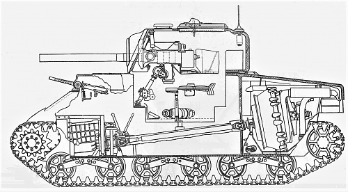

Paid to have the other files checked with the hope they had more, but it's basically the same as the other.
http://recordsearch.naa.gov.au/Searc...aspx?B=4938371
The CWM's copy of the 1942 manual has gone missing unfortunately. But the tank restorer had a copy of the 1943 one which they were able to copy.
Nothing on the Armour values in it as others had said. The general description included "The armour of the tank consists both of armour steel plate and cast armour steel. The lower hull is of armour steel plate riveted to suitable structural steel members. The top hull and turret are entirely of cast armour steel of varying thickness."
Except for one blurb in the turret section which seems to contradict any other source for thickness.
"The turret is a one-piece casting of two-inch armour"
Manual Lists the Gun as being able to elevate to +20 and depress to -7.5
In Canada's pride, Roger Lucy talks about the pilot Ram II tested in November 1941 on page 39 and 40 and some of the issues they had with it such as location of elevation gear, turret basket problems and such. He states they had concerns with the limited gun depression of the main gun being -10 to the front and -7.5 to sides and rear. Fixing it would have required redesign of both turret and rear deck. Joint committee on tank development agreed on December 11 1941 that -10 was acceptable.
Then on page 66 he lists the gun as being able to do +20 and -7.5.
I know the turret front plate changed at a later date and the inner mantlet had some tweaks at various times as well, but was the change so large that they lost 2.5 degrees of depression to the front from the pilot?
The Ram I with the 2 pdr is another ? on gun depression, I am guessing it was roughly in line with say what the valentine could do -15. Hunnicutt lists -10 but I believe this is incorrect. There are documents listing depression over the engine deck being limited to -12 or so after fitting intake protection plates for example.
The manual has some lovely diagrams and semi decent pictures of the tank.
I edited one and removed all the arrows crisscrossing it pointing out components to try and make a cleaner image for fun.
i.imgur.com/h6bFQCh.png
