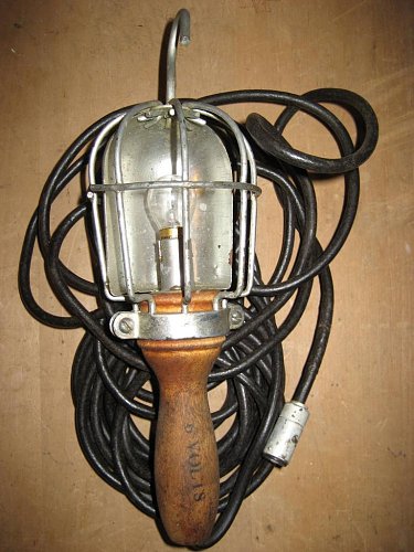

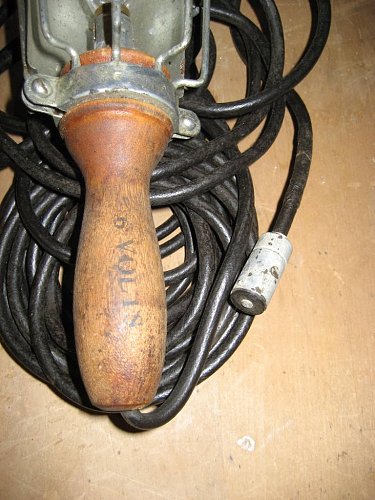

Hi Mark,
Here is a picture of my CMP trouble light from my tool kit. Hope this helps.
Derk
Name:	Ford CMP trouble light 001.jpg
Name:	Ford CMP trouble light 002.jpg
ID:	91086 Click image for larger version
Name:	Ford CMP trouble light 004.jpg

Old 01-06-17, 09:33
Adrian Barrell
Location: Suffolk, UK
Posts: 862
It's wartime and is the standard light issued with tanks and no doubt other vehicles too.
