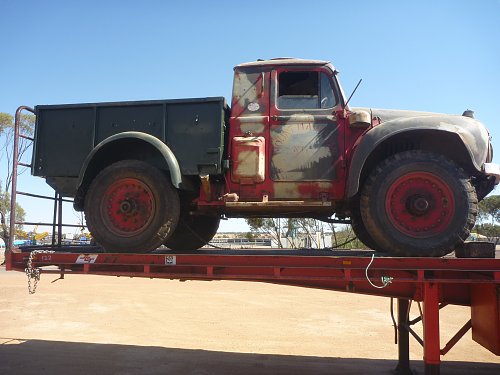

Bringing the Humber home - on the back of the trailer ready for the journey

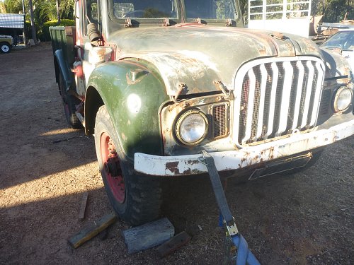

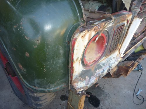

Damaged right hand front

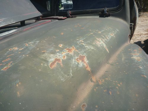

Hard to see but someone rubbed down with sanding disc

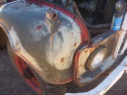

Main rust in roof LHS
Replacement guard trial fitted
Damaged front panel pulled into shape

Roof rust like yours is not rare, as well as inside the centre vent, and around the battery box etc.
You could always paint it back to the red, with all the markings, it probably spent more time red than green, and will be waaaay faster.
Be interesting to see if you can unearth the markings on the bonnet, hope it's not too late for wet&dry with plenty of water. As a side note, don't let anyone sit on the either of the bonnets, you will end up a major bumdent.....
