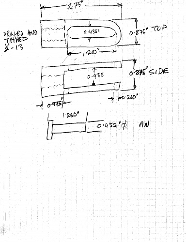

Dose anyone know of a couple of Hand brake fork equalizer block CTL 3298 for sale or failing that have the dimension please.

I'm working on this stuff as we speak, Stephen. I'll get you dimensions. Should be quite easy to make them.

Stephen, here's a sketch.
Malcolm

Malcolm, you might like to revisit the thread? I'd suggest 7/16" BSF (18 tpi)

Thank you very much for that, off down the garage to make a couple.

OK, Lynn. I double check.

Lynn, Stephen,
I checked the thread in the clevis I posted the sketch of. Definitely 1/2"-13 UNC. I see this does not match the 7/16" BSF specified in the Carrier parts manual. I don't know why.
This is a Canadian Mk II Carrier, built by Ford in Windsor, Ontario, and restored many years ago by the Ontario Regiment Museum.
Malcolm
Old 26-08-17, 05:40
Malcolm as far s I know, there aren't any 1/2" rods in the riveted carriers (not so sure about late production or T16)
If it has the part number on it, then someone has drilled and tapped it.
