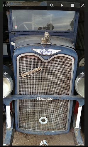

Hello.
Please help identify cars.The photos were taken in Palestine, in the late 30s.

I believe these are Transjordan Frontier Force vehicles. Either Morris-Commercial or Commer truck, I do not have my references at hand at the moment.

The file name for the first photo might suggest a Saurer truck, but Saurer's radiator crest seems to have been round rather than the winged shape shown in the photos - so I have doubts about this suggestion.

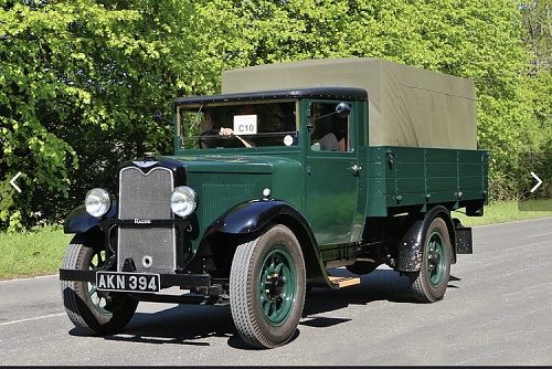

Do you mean one of these two machines ?
So they signed the file on the network. I initially did not consider this version.
Indeed. The Commer Raider radiator is quite distinctive:

Konstantin, I saw Your request on "Reibert", but I'm not registered there.
These photos were discussed in different places quite often. This is not Crossley or Albion. As a result of those discussions, it turned out, that this is the military version of 1934 Commer "Raider" B30 truck (see Hanno Spoelstra reply above).
The front spring is just a spare spring (obviously, since the vehicle was of civilian origin, some of its parts were weaker, than if the vehicle was originally designed as a military one).
