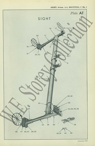

Default Bofors Sight
This is the wartime Bofors sight.
Name:	48A. Plate AT - Sight.jpg

The wartime Bofors sights are interesting, But these are 1957.. what did post war sights look like, also if you look at the mounting hole area on the wartime bofors diagram , its similar to the unidentified sight bottom....
