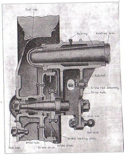

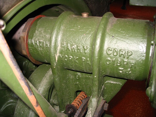

The conversion to rubber tyres (at least on the example we have here in Shilo) was a Martin Perry conversion, and was common on several of the WW1 vintage guns thru the 30s. It allowed much higher speeds and less maintenance, especially as horses were being replaced by vehicles. It should not be hard to convert back since the original axle still exists underneath the hub adapters for the rubber tyres. I can't speak though as to some of the bracketry that supports the adapters. It seems to me these may have been riveted into place along the caisson. In Canada, the 4.5 with rubber tyres were only used for training purposes in WW2, and not for operational needs. Finding original wood wheels will be tough I suspect. However, I see on Wikopedia talk about other conversions, one of which included cutting off portions of the stubs. You might be in for a little more work if that is the case.

The conversion from spoked to rubber tyred wheels used the Martin Parry kit, an American design originally used to convert the (ex French WW1) 75mm guns used by the US Army, to be used with rubber tyred wheels. The same was used for the 18pdr guns.....one example of a 4.5" howitzer here in the UK, has the Martin Parry design, with "18 pdr" cast on the body.

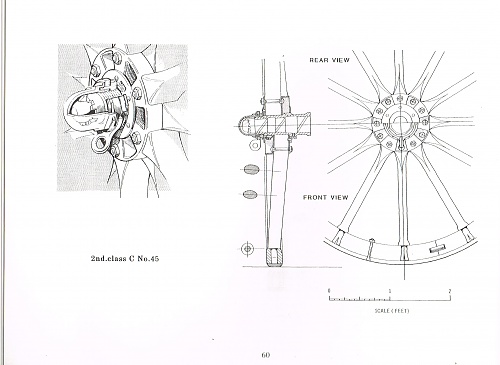

The enclosed drawing is from the book on British Quick Firing artillery by Len Trawin. It has some excellent illustrations and cut away for the 4.5.
Also included is a section on the types of wheels.
The 18pdr and 4.5 used the same wheels, as did the limbers.
The official designation was 2nd class 'C' No 45.
You can see the spokes are offset to the next one around.

Looked at the units again yesterday and the 4.5 has the conversion marked "18 pdr" as shown in your earlier picture. Interesting.
