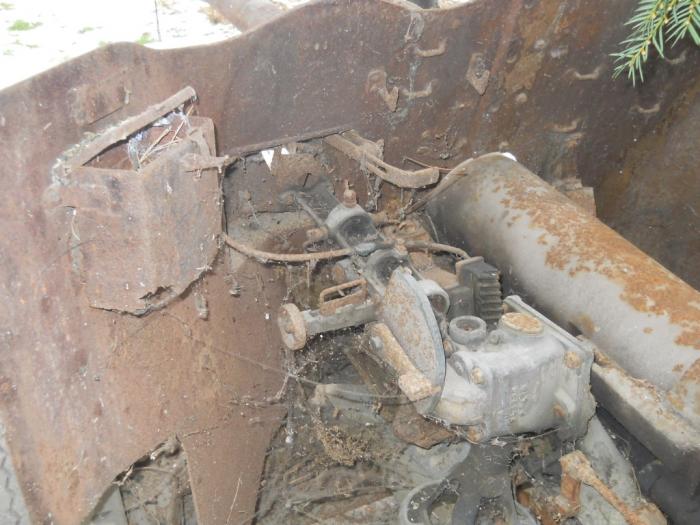

Instantly an inspection begun. We were really lucky as the gun was in very complete state. There were some scars, the barrel, breach block and recoil housing were punctured, the spare parts box rotten through, but everything else in good shape and easily restorable.
stavpred 015.jpg   stavpred 034zmen.jpg   stavpred 035.jpg   P1271959.jpg   P1271960.jpg

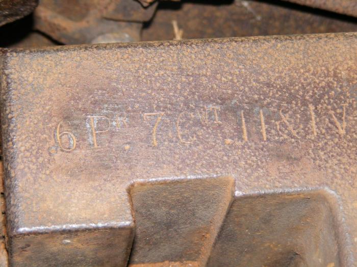

Did not really take long and we started the restoration. We acquired some manuals and started to dismantle parts. Everything came off quite well unlike the barrel which was a really tough job. We were suprised that the recoil system was like new, luckily under a thick layer of grease.

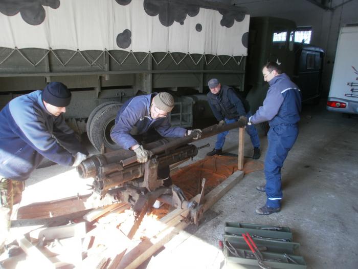

After the assembly of the recoil system, elevation gear, shield etc we put the barrel back on without any big difficulties. We yet have to make the leather seals for the recoil rails.

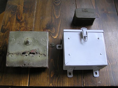

We had to make a new spare parts box for the shield, the original rotted away...

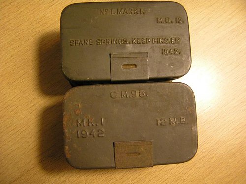

We always wanted to blank-fire the 6pdr so we bought a firing pin from forum member Rob and took the barrel off again in August. We had taken it to a gunsmith who made some adaptation to the barrel to allow black powder firing. He also made a special rounds for the firing. After that he s taken it to a state approval laboratory and they issued a certificate and marked both the barrel and the rounds. Now we can blank fire anywhere without a temporary shooting range approval. It really works
The blank rounds will yet get a brass finish to look more authentic.
We also made a replica of the sight holder. Thanks to Marc van Aalderen for providing the dimensions.
IMAG1376.jpg   nabojky.jpg   nabojka%20tormentovana.jpg   odpalovac.jpg   optika.jpg

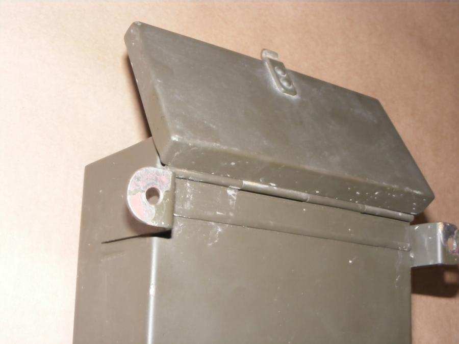

Default 6 pdr spare parts box
Hi Dusan, thank you for the offer, it's no problem for me to make a box, it's what I do! Without a pattern however..... a drawing will be great.
Adrian,
a friend of mine made a drawing of the box. I hope this helps, if you need any more info contact me. I have also attached pictures of our replica box.

few more pictures. By the way does anybody know what the box should contain?

Hi Dusan,
Yes, I do. The rectangular hole is for the little tin with spare springs, split pins and other assorted small parts. I have a list in one of the handbooks that tells what exactly. These tins come up on Ebay regularly. The round hole is for a spare firing pin, possibly with the spring but have not yet tried to fit it.
ID:	64058 Click image for larger version
