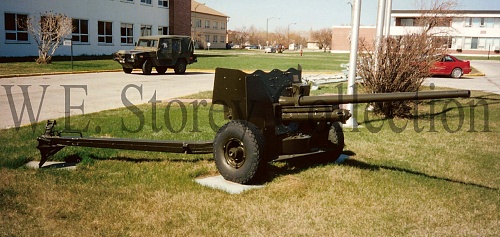

Here is a photograph of "David" when it when it was still parked beside the parade square at CFB Winnipeg in 1997. I wonder what happened to the brass plaque that was on the gun shield?
Name:	C317-25 (David).jpg

No idea about the plaque.....if you look at the photos of the gun on the link I gave, there is one with a plaque of some form sitting loose on the breech ring. That photo was taken here in Shilo before I worked on the gun, so if that was the plaque you were talking about, then it appears to have found it's way loose.

Yup that looks like it. I was hoping the plaque would be wartime with some unique information on it - oh well. Good to hear that Shilo has the gun and that it is not sitting in a scrap yard.
