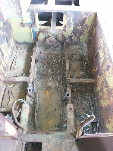

Question re, British steering wheels.
Were they made in full circle and/or half circle versions?
Just got one with a half wheel style and not sure if it's original or a bush repair job.
Also picked up an LP2A at the same place.
Both need a lot of work, but it's a start anyway.

Also, are these British brake hubs and sprockets?
These are part of a modified axle assembly that was apparently made using carrier parts after the war. I have not checked to see if the sprocket is the same as the carrier ones as yet but maybe the brake drums would identify it if it is British?

number 4425 from what I can see
No identifying marks on the Brit one seen as yet, the spot where it would be stamped is gone. But there are remnants of painted number 909 (I think) behind the gunners seat.
Old 06-11-18, 13:19
ajmac's Avatar
ajmac ajmac is offline
Alastair McMurray
Join Date: Sep 2006
Location: Lincoln, England
Posts: 435
Although the drums are too small a diameter to be from a Loyd carrier, the curved plates which are used instead of nuts for the sprocket bolts look like those used on the rear axle of a Loyd. Drums look standard Universal Carrier. Look at the front face for numbers and dates.
Alastair
Lincoln, UK.
Under Restoration:
1944 Ford WOT6 Lorry
The Loyd on Facebook
Old 06-11-18, 21:54
ajmac's Avatar
Alastair McMurray
Join Date: Sep 2006
Posts: 435
Looking at the overall axle width I’d actually say that whole assembly is from a post war Loyd crawler tractor.
Alastair
Lincoln, UK.
Under Restoration:
Old 06-11-18, 22:39
Glen Plumridge Glen Plumridge is offline
Join Date: Oct 2018
Location: Maitland NSW Australia
Posts: 35
Just checked some photos of Loyd crawler tractors and the body work on them does look the same as what I had to remove from the axle.
The fuel tank on those is the same as the ones I have seen there as well.
Wondering now if there is any demand for them to restore the tractors, rather than me pulling it apart for spares. It would be a shame to destroy something that's valuable to someone.
Casting numbers on the part that the sprocket bolts to appear to be BS600 and 1945

Sprocket is a 35 tooth, so will work for the Brit carrier.
After 3600 + km of traveling back and forward this past week ferrying trailer loads of parts everything from out west is back at my place.
The LP2A will be the focus of my effort initially.
First step is to clean out around 50kg of dirt from the floor.
After cleaned and washed out
Need lots of parts so if anyone has bits for sale in Australia please let me know. I will put a WTB ad in the correct forum with a list.
