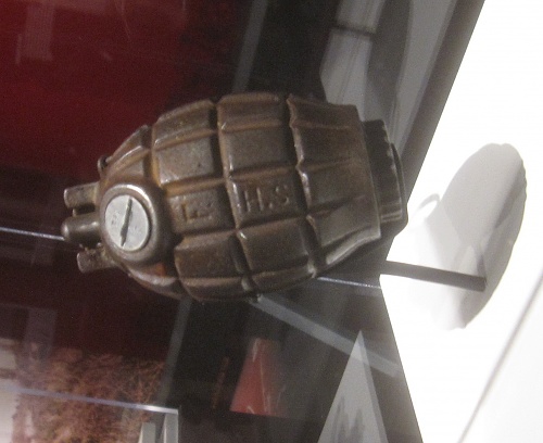

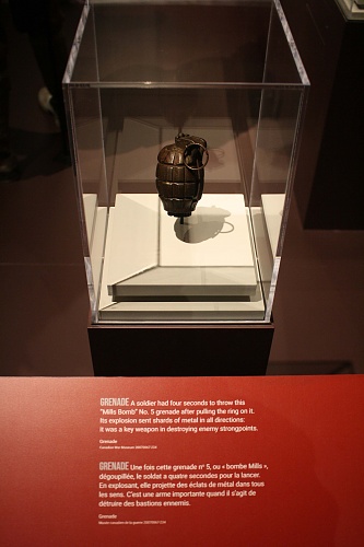

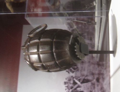

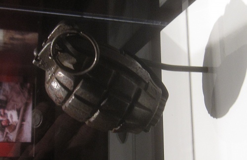

Some interesting 'alternate facts' are contained in this display.

Please tell us that this was from an April Fools display. That looks an awful lot like a no36 or a 36m to me (large filler plug, detonator striker design, the flat style spoon, possibly the baseplug....). Also, didn't they have a 7 second fuze? I thought the fuze time was reduced in WW2 to 4 seconds, again on the no36m. But the time count didn't start until you let the spoon go.....a soldier had as much time as a soldier needed.

Rob, sadly it is part of a much larger technically flawed display. I think the text for the grenade caption was based on information provided by Wild E Coyote.

Considering the money and resources dedicated to these major 'art gallery' style exhibits, it is appalling to see that the facts relating to the basics of how a grenade functions could be so misconstrued. Add to this that the grenade being displayed doesn't even match the text and you have to wonder what else is incorrect.

Unfortunately, it is one of a series of captions of about the same quality in the CWM, and they don't seem to want to know, either.
Wrote to the Director several years ago about a few of their display captions, suggesting further investigation with a view to correction if they agreed with my comments and evidence provided.
No reply. Not a squeek. As far as I know, no caption change either. Every museum makes caption errors: the real test is in correcting them.
Check out their 18 pdr shrapnel shell caption. It's a real beauty!
As for the No.5 Grenade, which is similar to the No.36 or 36M, one of the tell-tale difference in the body casting is the flair in the bottom below the segmentation, which is correct for the No.36 or 36M, but not for the No.5, which is segmented all the way to the bottom and does not have the flair. The top casting surrounding the striker is also different on the No.5 compared to the No.36: the No.36 has a smaller casting that does not extend past the striker pin.
So I think this is a No.36 or 36M, not a No.5. And as Ed has said, the No.5 had a 5 second fuse ('detonation within 5 seconds of the release of the lever' the spec reads), not a 4 second fuse on pulling the pin!
