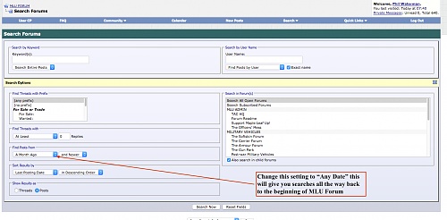

Hi Zdenek
Unfortunately the MLU advance search is not as easy as one might hope, in particular Find Post from setting often seems to default to a short period of time.
Name:	Advaceed Search.jpg
Once you have fixed that then searches become more productive. Here is a Advanced search on the word "wiring" and Post Made By: Phil Waterman that I've narrowed down to those with information more directly related to Pattern 11 & 12.

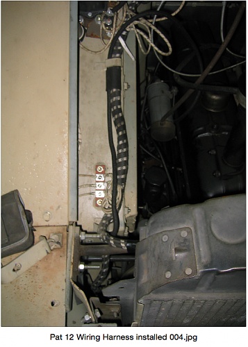

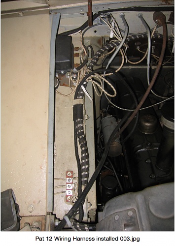

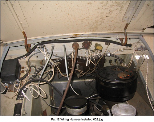

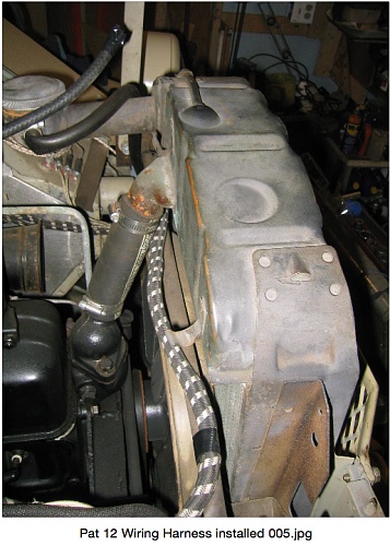

Default Pattern 12 C60L under the hood
Hi Zdenek
Hope these photos will help with the routing of the wiring harness under the hood. What is shown is my C60L Pattern 12 with a new wiring harness, it was installed based on the existing original harness that was pretty much intact.

The wire attachment blocks shown are from a Jeep parts source and are a match for the originals.

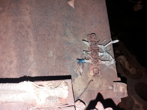

Hello everybody,
thanks a lot for your answers, it helped me to go on with the restoration.
So far I managed to connect recharging and ignition...
The blocks are from Jeep? But which type? What I know it has more attachments... Or did you modify it?
Zdenek

Old 22-11-19, 04:08
Posts: 5,264
Default Generic junction blocks
The blocks shown by Phil is a generic and is sold by quite a few restoration retailers, Chevs of the 40s, Jim Carter,etc......
For the cab 11/12 the 3 connection ones are what I have seen as originals.....you can use one of the mounting end screws for a ground.
Good luck
