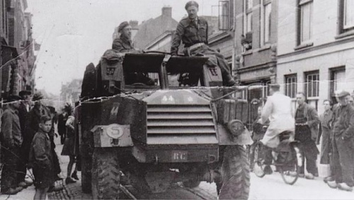

After a considerable time studying photos of C15TA’s I realized how many modifications had been done to these vehicles. Soldiers being an innovative lot made changes to things in order to make their survival more likely and life easier. My aim initially was to make my truck a little different than others. We want our vehicles to be historically correct for the rivet counters and not make absurd changes or additions. I will start with this photo and my uneducated guess. Is #1 an aerial I am not familiar with and is #2 the end of a smoke discharger?

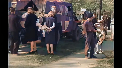

Here are two ammo type cans mounted on the front fender that could be for medical supplies.

Looks to me like item #1 in the photo is the side of the top bow for the canvas superstructure.

Good eye Derk. Now that you have pointed that out it is very obvious. That knot of canvas or whatever at the curve was what was throwing me off.

I'll second that. #2 is just part of the canvas rolled up, I reckon.

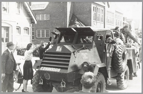

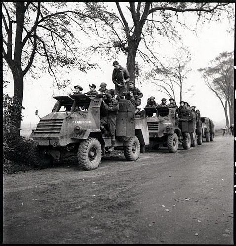

Thanks Jordan for the five photos. I don't think I have ever seen #5 before. Here is a photo of another C15TA.
#1 a chore horse mounted on POW rack a little differently
#2 Gerry can strapped on front fender with proper straps
#3 just one of the aerial locations
#4 roof rack
Barry

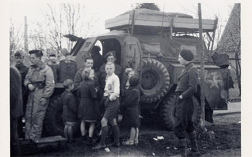

#1 another example of ammo cans mounted on the fender
#2 chore horse on the fender with a modified "hot rod" exhaust
#3 a shorty roof rack

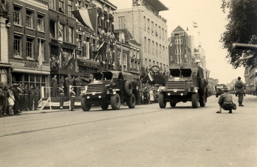

ARISTOCRAT sure gets around.

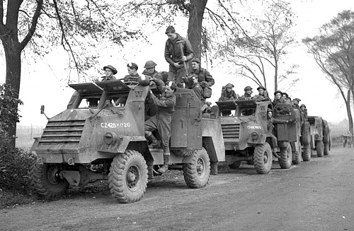

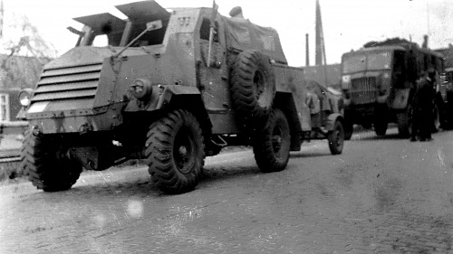

Here is another photo for all you who are not bored yet.
#1 Aerial mounted on roof. I am not sure how they did that but it could be like
the Command vehicle.
#2 Aerial mounted by the top of the windshield
#3 Spotlight
#4 Winter cover
#5 Number on door
#6 Chains
Old 28-04-25, 16:02
#3 Spotlight
#4 Winter cover
#5 Number on door
#6 Chains
Barry....just a thought.... I wonder if aerial #2 is mounted in the same position, but mirrored, from position #1 (?).
Old 28-04-25, 16:56
Posts: 2,323
I also wondered (without knowledge) whether the #2 antenna could be mounted to the left of the vehicle but further back and appear to be forward on the centerline.
Old 28-04-25, 17:50
Posts: 3,704
Both those aerials appear to be F-Section whips and the near side one is fitted to a 19-Set rubber cone base. It is possible this C15TA is rigged per specs with a 19-Set HP on the near side and a 52-Set on the far side. That installation would have been built and installed in the field.

Alex they do look like they are mirrored but I do have a photo of an aerial base between the windshields. I wouldn’t want to mount an aerial to the roof as pictured and put holes in the canvas. I don’t even want to put any holes in the body.

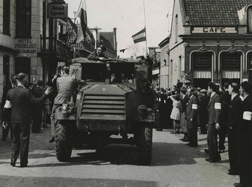

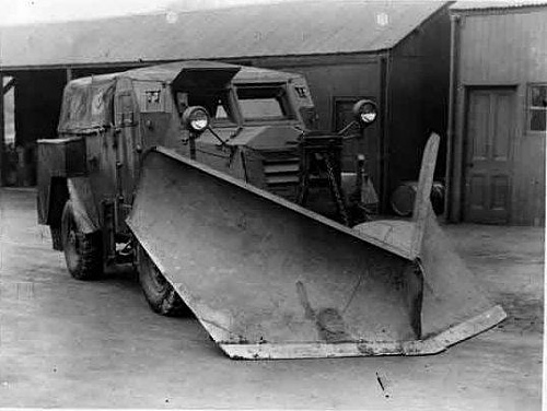

Leash.
Old 13-05-25, 00:48
Posts: 2,323
Maybe it is a parking brake...
Old 13-05-25, 01:21
Leash.
That should be easy to replicate....
Interesting to see those small headlights in favor of the big CMP style ones in your latest pictures, Barry. I did also spot some of these smaller lights on C15TA's during the liberation of Holland.....a "late" production feature.....or more likely a replacement?
