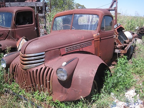

I have my Father's truck. WW2 desert guards
Name:	My Truck.jpg

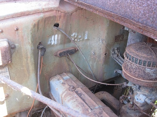

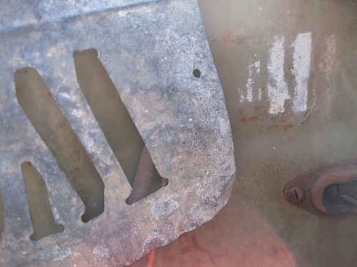

Firewall Stencil M 291 or upside down W 291

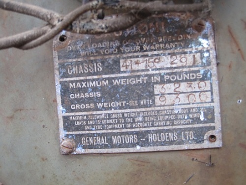

VIN Number 14 - 15 S 291
Engine Number

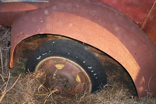

136 inch wheel base
I have searched MLU, Stovebolt and many links,
I am unable to identify this truck,
Please could some one help?
All suggestions will be gratefully received
Cheers rod

Old 24-12-17, 06:02
Posts: 2,400
1941 Chevrolet Series 15.
The chassis number should be 'findable' in AWM126:
https://www.awm.gov.au/collection/AWM126/
Good luck. There are only 120,000 vehicles listed, but yours should be in the earlier AMF registers (probably a five digit registration).

Good day Rod,
Welcome to the forum, you have a lovely truck.
I researched my Australian cabbed Chevrolet truck earlier this year using the AWM registration books to find out a tiny bit of history. It took a lot of hours to find the chassis number but I was able to find that my truck had been to the Middle East on the ship Tricolor spelt Tricolour in the AWM books.
The other thing I found was the trucks with the small wheel stud, 18 inch rims like yours are 30 cwt (1-1/2 ton) and the trucks with the bigger stud, 5 stud 18 inch rims are 3 tonners.
The rims are not blitz they are uniquely Australian Chevrolet and are stamped GMH.

If is is a 30 cwt chassis the original tyre size would be 900-18 . The firewall stencil looks like 41 = 1941 not M or W .
Good luck finding 18" tyres . Back in 1998 I was offered one of these trucks for next to nothing , located on a farm near Kilmore.
Old 24-12-17, 11:18
Join Date: Jun 2010
Location: leopold, victoria
Posts: 1,035
11.00 x18” tyres are available now from Coker Tyres in the States.
I have 5 en route by sea now for my Ford/ Marmon Herrington.
They are not cheap but I found bringing them in myself was cheaper than buying them through Antique Tyres in Melbourne.

Old 24-12-17, 19:59
Posts: 2,400
Default Gs
Rod,
Your truck was originally configured as a 'Lorry, 30cwt, GS' (tray body with fixed sides and front, with tailgate). Registration number C-23442. It still has the original engine.
Taken on charge in 2nd Military District (ie NSW) which figures as it was built in GMH's Sydney plant (the 'S' in the chassis number).
Disposal to GMH.

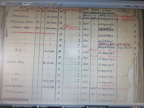

Old 26-12-17, 00:20
Rod,
Disposal to GMH.
Mike, where do I find the "C" prefix ARN's. I have sleuthed through the AWM 126 books but have not found any "C" prefixed numbers. I have seen plenty of "C" numbers in photos but don't know where to look them up.
Thanks Rick.
Old 26-12-17, 19:15
Posts: 2,400
Rod,
Go to the bottom of this page:
https://www.awm.gov.au/collection/C2143574?image=104
Rick: re 'C' prefix: see my latest post under 'NT Pics'. For a more detailed explanation of the AMF and AIF registration schemes and prefixes, see pages 6 & 7 of my AMEP Volume 2: LP Carriers.
It is not a upside down W but as you said a 41.

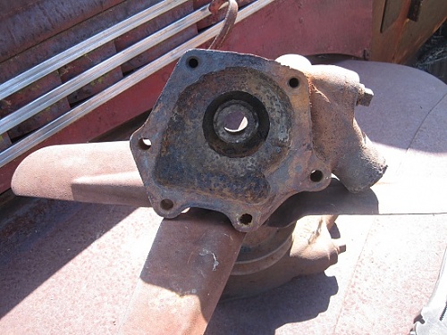

And finally, What are these tanks for ?
They are different. Both have a pipe fitting on opposite sides.
These pipes are at differing heights. There is no other way of getting any substance (air/water/petrol) inside.
Cheers rod
Old 27-12-17, 08:36
Posts: 2,400
(1) the holder on the left is for the small oil can. The 'holder' on the right is an overflow tank with the end cut out and apparently fits a bottle - not a standard fitting.
(2) the tank on the right is a CMP overflow tank. Don't recognise the one on the left.
Old 27-12-17, 09:16
The one on the left looks like the bracket and overflow tank for a Ford Lynx. The bracket is made to suit the angles on the right side of the engine bay. The tank is actually an identical size to the other although in the photo of the two tanks, the left one looks smaller.

Old 28-12-17, 11:10
Rod,
Thanks Mike C. I have finally located the correct AWM126 books . Seems I had looked at the AIF not AMF books and did not realize that the "C" prefix was dropped in the books.
I also pulled AMEP Vol.2, out to refresh my memory after your advice.
Interestingly at the top of the page on which my Staff Car ARN M-15 Chev 5 passenger is shown, is M-1, the Rolls Royce "Wraith" (Chassis No WRB40, Engine No. K4WV.) with a body built by Kellow-Falkiner which was on loan for the duration of the war from Mr George J. Coles of Melbourne. It was returned to Mr. Coles in 1946. During the war it was used by Gen.Sir Thomas Blamey. After returning to Mr. Coles, it was registered with Vic Rego. HN-000. It is still around. There were only 5 "Wraith" model Rolls Royce cars which came to Australia before WWII. All are still around although not necessarily all still in Australia.

Posts: 2,400
Rod,
Forgot to mention: the '41' etc under the bonnet/on the firewall is part of the underbonnet nomenclature required by the Army for all vehicles from around August 42. Vehicles already in service were supposed to have it applied by units (but were not always), so we see a wide variety of methods of application on older in-service vehicles - rough or well hand painted depending on the skill of the 'artist' and the ease of access. Stenciled like yours is less common on vehicles already in service, making the marking's preservation something you might consider as you progress with the restoration.

Thanks Mike,
I was thinking to maybe leave the firewall as is un-restored
You have convinced me now,
Thanks also fellers for identifying the little tanks
The discussions you-all are having is interesting
Cheers rod
