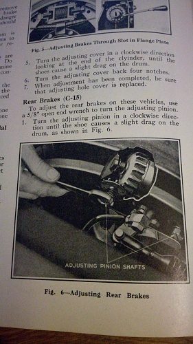

Old 13-10-19, 23:08
Posts: 14,940
Default Per the manual
To be clear: the rear brakes on my C15 do not have these adjusting pinion shafts:
So I tried using the method for the front brakes, but because of the rear springs, there is no room for the screw driver handle:

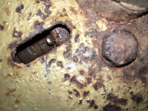

Old 13-10-19, 23:39
Posts: 14,940
Default inside the drum
Tried to take a pic of what the inside look like:

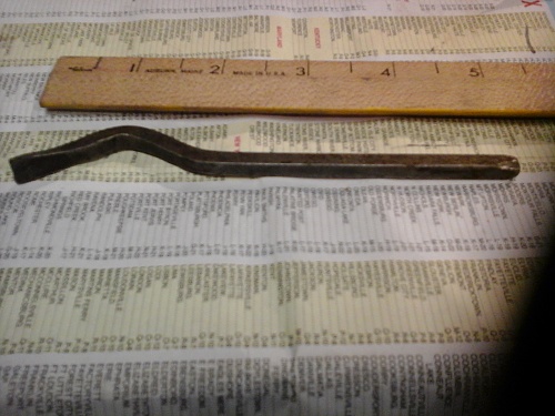

Old 14-10-19, 01:37
Default Special tool #27257
Hi Hanno
I agree with Rob you need a brake adjustment spoon tool. I made mine which I will photograph and post. There is an issue of clearance to the springs. The things to remember is which direction you need to move the tool back off each end of the cylinder.

Old 15-10-19, 00:46
Hi Hanno
Here is the little tool made for my HUPs first brake job, 40 years ago.
ID:	109534Click image for larger version

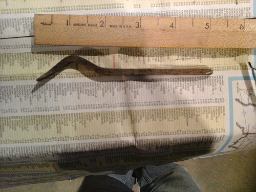

Old 15-10-19, 01:08
Posts: 14,940
Thanks Phil,
Did you make this yourself or is this an off the shelf tool?
Just tried my friends home made tool - sadly that didn’t work...

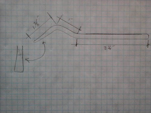

Old 15-10-19, 14:55
Hi Hanno
I made it because non of the commercial ones worked. Made from some key stock heated and bent to shape.
Will take a better photo with dimensions and angles.
If you wonder about the Special Tool # 27257 I have a tool drawer where I put all the tools I've made over the years for the CMPs.

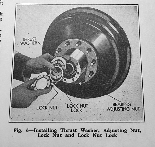

Old 16-10-19, 13:35
Join Date: Sep 2011
Location: North Vancouver, BC
Posts: 307
Hanno,
If you do end up pulling the hubs, you need a kent-moore J870 wrench (attached - the one I have is missing the tommy bar) for the special locking nuts on the C15 rear axle. You can use a punch and hammer if you don't have that wrench, but be careful not to damage the nuts.
From my recent experience, the brake linings on my C15 were pretty much welded to the drum. To confirm what Rob suggests, I ended up 'working backwards' and unbolting the backplate from the axle, unbolting the wheel cylinder and disassembling that way.
Owen.
kent-moore j870 wrench.jpg   WP_20190120_13_21_36_Rich.jpg   WP_20190120_13_23_31_Rich.jpg   WP_20190120_13_23_43_Rich.jpg   GM473636 rear axle nut.jpg

Old 16-10-19, 19:54
Hi Hanno
Can't find my protractor to measure the angles, but here are the the measurements and the outline of the tool on 1/4" graph paper.

Old 16-10-19, 23:47
Posts: 14,940
Thanks again for all the tips and info
Alex van de Wetering looked up and cross matched the lock nut number 473636 as being the same on a GMC truck. So the GMC tool should work on the C15 lock nut as well.
Will report back later!
