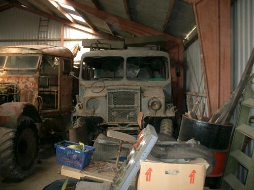

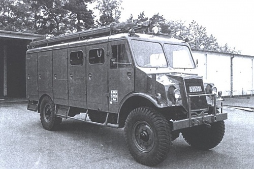

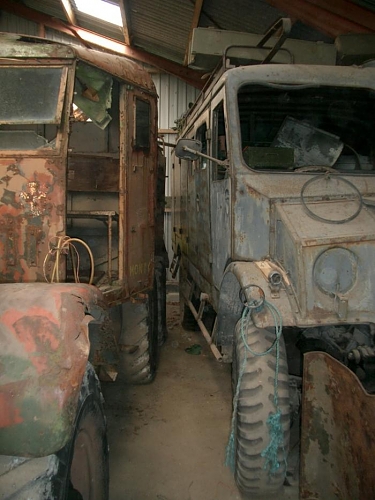

hope some of you, can help with this,
One of my freinds own a Chevy with the Vehicle model # C-60448-M-GS-11
what type of truck was that?????
it is fitted with a original winch.
it has been convereted it to fire truck by the danish Civil defence. The last picture is one like it.

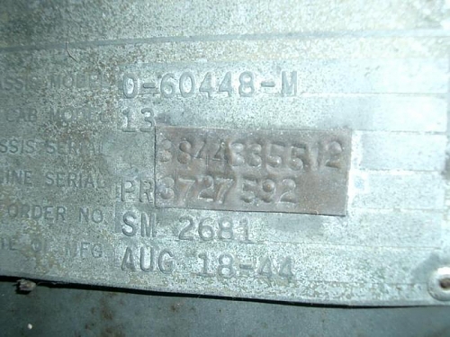

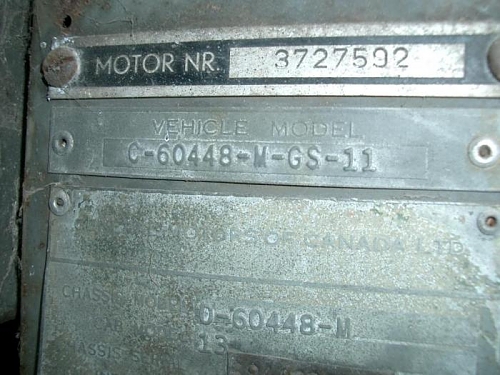

It should be a 158"WB General Service truck. The 158" looks like it could be correct, but as pointed out it has been completely rebodied for a better fit to their planned use. I assume you have also noticed that the main data tag has an added plate on top of the main plate for chassis number and engine number, presumably added at rebuild time (it matches the added plate for motor nr.) The winch is more common on special purpose trucks such as the FAT, Winch, Derrick or Engineers bodies, but other GS trucks have shown up with winches that appear original.
alright thanks, I am fairly sure that its the same lenght as a normal c60l as there is one parked in front of it.
So It has just been a standart flat bed lorry fittet with winch. it was the M in the Vehicle model # C-60448-M-GS-11, that had me thinking that it might have been somthing like a machinery version.
the reason for the missing front bumper is that the owner is using it on his CGT.
We are thinking of modifying the rear, so that it can be used for sleeping in, with out changing the body on it.

That is a new British Ministry of Supply Demand on me! It must have been a 1943 contract, and for Australian delivery. I always hope that I will find more unknown Aussie S/M contracts, but usually they are Ford ones.

Here is a link to another survivor, courtesy of Niels: http://www.beredskabsstyrelsens-biler.dk/17898849
I think this is the same example: http://www.historical-fire-engines.c...?image_id=1272
An automated translation learns this is a hose tender truck for the Danish Civil Defence forces ("Civilforsvaret", or C.F.). They were know as "Brandudrykningsvogn" or Fire emergency truck. Seating 1 driver plus 9 firefighters. The vehicles were purchased used after the war and rebuilt in Denmark by I/S Karofa, who converted 36 of them. They were in service from 1978 till 1982.
