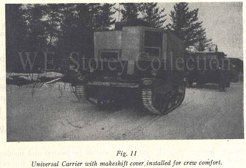

Posts: 1,730
Default Exercise Eskimo
As Rob mentioned, makeshift enclosures were made for the exercise and here is an image of one mounted on a Universal Carrier.
Name:	Fig. 11 Universal Carrier with Makeshift Cover..jpg
