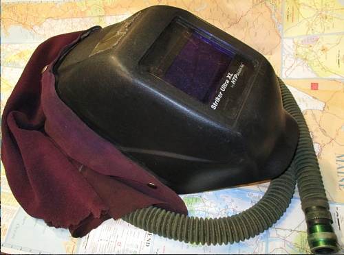

Like Grant suggested add a leather drape to the back to cover the back of your head and shoulders, not having light come in the back and reflect of the inside is a real advantage, particularly if you are welding outside

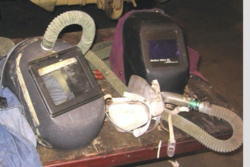

Now to take your welding comfort to the next level, consider taking your helmet with leather back drape to the next level with supply air. Cool air on your head, the screen doesn't fog up, no smell, no toxic vapor in the helmet. My system is home made using surplus or repurposed components. Total cost probably under $200 and that includes a grinding and sanding helmet with air supply. Little more work to add a supply air painting mask.
I'll dig out photos of how later today, the purple of the leather has faded a lot over the years, it started out a very bright purple. The last photo is of some of the other masks for the system.

Blower is mounted up on the 2nd floor of the shop on the north side so it is pretty cool air.
Word of caution with supply air to welding mask, be sure to have a smoke detector in the shop. Once set fire to my sleeve and didn't know it until my arm started getting hot.
