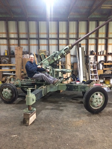

Default Picture
Guys,
I live in the same county as Jon, and just had to go and visit when I heard about his latest acquisition. Maintaining the correct social distancing, I was able to catch up with all the latest and check out his new piece. For an infantryman, Jon has a definite soft spot for artillery.
I also know how much we enjoy pictures, so here's my contribution.
Peter
Old 07-05-20, 03:27
Jon Bradshaw's Avatar
Join Date: Jan 2009
Posts: 270
Default Thanks everyone
Thanks Peter for the pic.
Everyone else thank you for the interest. The wheel sub thread was interesting.
The pile of tools that came with it was also excellent, the shell removing tools are key as once they are in the loader they don't come out easy without it.
Here are the anticipated photos. I can put up more but for now these and the one from Peter should suffice.
As you can see there is very little rust and aside from the "modern" parts attached and the bad black and green paint scheme it looks like a vintage from the blitz.
bofors coming home.jpg   my new bofors 2.jpg   My new bofors side.jpg   my new bofors 3.jpg   tools.jpg

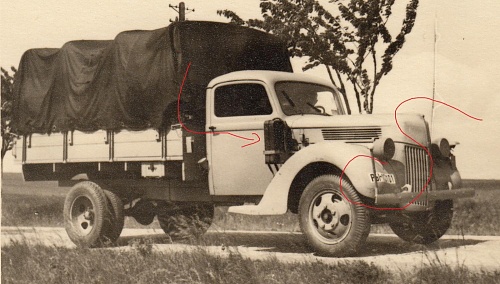

Default Spare wheel....?????
I was sure I had a spare wheel Jon
................. but turns out to be quite different.
Is a 20 in. rim with a 32 x 6 old style tire........
....... available to anyone who can justify the use......
Old 11-05-20, 19:15
Location: France
Posts: 32
Hi Bob,
I think your wheel is a standard 20" Ford 3 ton (here on a German Ford V3000 but other nations mounted them).
https://i.imgur.com/DFMLtTT.jpg
Patrice.

Old 11-05-20, 23:31
Posts: 566
Ten stud on a Ford ?
Old 12-05-20, 00:26
Posts: 5,261
Default 5 versus 10 holes......
It seems that in that era a lot of wheels had 10 holes drilled but only five used in front and ten in the rear and they got around to five studs in front by using a 1/8 in. thick spacer between the nuts and the rims thereby hiding the extra 5 holes...... very common on GM and possibly GMC....Maple Leaf..... no experience with the Ford.
The wheel does look similar to the Ford pictured.
Thanks for the info..... wheel remains unspoken for......
