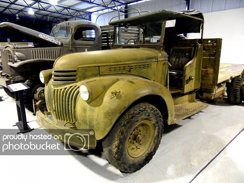

Looking for information, specifically the width and backspace of the 16" (8 bolt) split wheels fitted to 1.5 ton Australian Chevrolet trucks between the years 1940-1945. The posting below is from February 4th. Thank you.

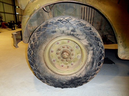

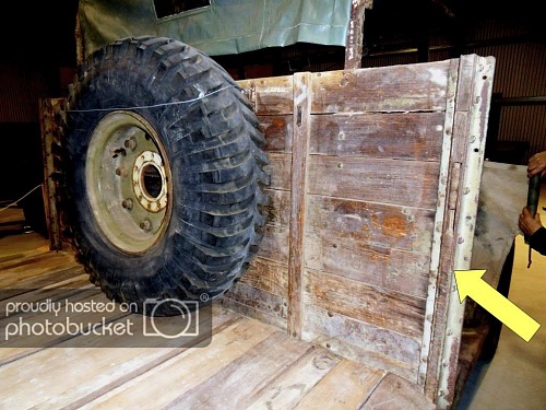

https://www.facebook.com/groups/66266488488/
Here are Philippe's pictures:
ID:	106413 Click image for larger version
ID:	106414 Click image for larger version
ID:	106415 Click image for larger version
Source: https://www.facebook.com/groups/6626...7100302738489/

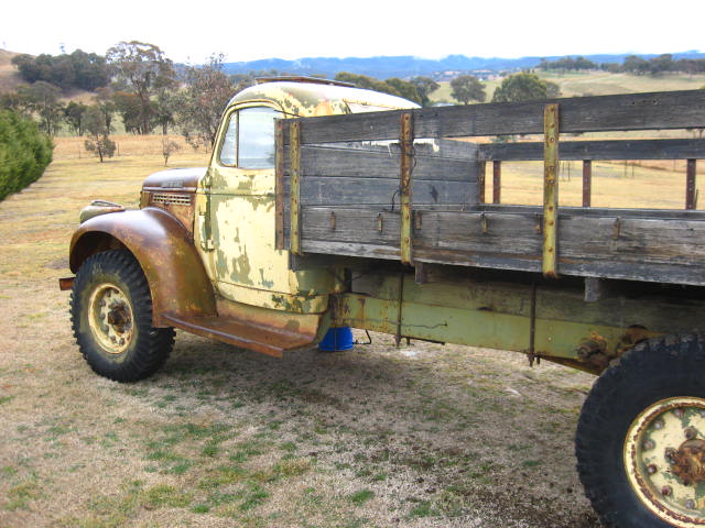

The famous Australian rim was therefore an 18 inch rim of similar concept/design made by stamping two halves in 1/4 inch steel plate.
Do we know who made them??? and probably sourced in Australia. Were they stamped by the maker like the Kelsey-Hayse rims.
Second question.... concerning the origin of the brake drum posted last in Hanno's posting........... I have a similar picture taken from the wrecks of North Africa...... attached...... from the picture I have concluded that it is a Chevrolet chassis from the cleanly sand blasted sheet metal, indentation on the frame for locating a LHD steering box and the spring layout. The fender seems to indicate an earlier version of LRDG using a 38-39 or 1940 round fender model.......
Does any one have a larger picture depicting that same vehicle but in larger format showing the cab style. So far I have not been able to find any references in GM part manuals for that elusive riveted brake drum and I have many.......

The manufacture of the Chev 18" split rims is mentioned in the GMH 'War Record' book. My understanding is, GMH made the rims themselves , GMH had a huge press for the job . Don't know where Ford Australia got theirs from . Anybody know ?
The GM/H 18" rims look quite different to the WD-Pattern 16" and 20" rims in that they have have quite a few more rim-half bolts in a smaller thread than the British design rims.
Ford Australia's rims seem to be more faithful to the British/Canadian design, so I wonder if they are Canadian supplied?

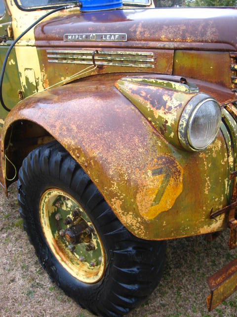

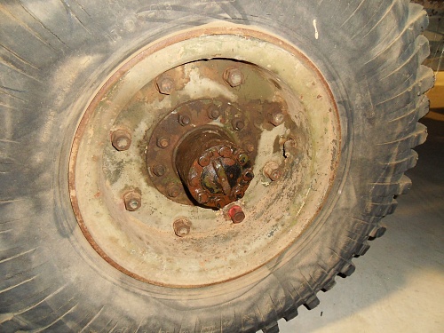

And then there were the heavy-duty 5 stud wheels made by GM/H for the Australian Maple Leaf trucks.
Old 05-04-19, 03:21
Posts: 566
Tony,
Are those Maple Leaf 5 stud ones 16" or 18" ? I am guessing 18" as they look very much like the 10 stud GM/H ones and also have twelve studs holding the halves together.

I think at least some of the British rims were made by SANKEY .... Was Sankey owned by Dunlop ? Pretty sure my Morris CS8 rims are marked SANKEY but I will have a look. Also found brass wheel nuts on a CS8 I have ....
BTW that's a nice original Maple Leaf truck . Are those 10.50 x 18 tyres
