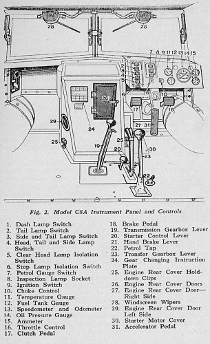

Default Five or Six Switches
Hi Bob
Thought I'd add another variation to the question, most of the reproduction pictures I have seen have five switches. My late '45 HUP as a six switch plate. I've attached a couple of pictures to illustrate the differences. Can anyone shed some light on when this change took place and is it peculiar to HUPs.

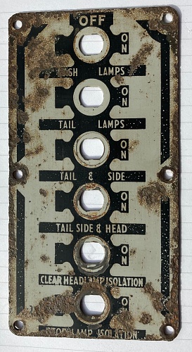

Old 22-07-20, 11:21
Posts: 14,911
Never seen another one of these 6 switch plates until Sjoerd van de Wal offered me to buy his example. I bought it as a conversation piece.
It has the usual switches plus an extra one in the 5th position (from the top) for “clear headlamp isolation”.
