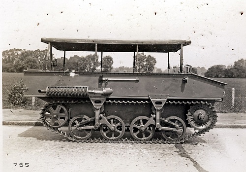

Default "Anybody recognise this one?"
Originally Posted by nuyt View Post
Please take a look at this picture (not complete and not very good quality - but it's all I have) of a Vickers Artillery Tractor as tested on Java around 1939.
I cannot find any references to the exact type of this vehicle and need some help here. The tractor reminds me of an early Lloyd carrier, but this scene is around 1939.
Seems this is the subject vehicle: https://tankdevelopment.blogspot.com...-chertsey.html (my bold):
Artillery Tractor 1929 Chertsey Demonstration Model D42
The caption to this photograph in Album Two adds:
also
611 Light Dragon Mk IIC - Greece 1934
612 Light Dragon Mk IIC - War Office 1935
614 Light Dragon Mk IID - India 1936
615 Light Dragon - Siam & Java 1939
This is the high sided version of this vehicle.
