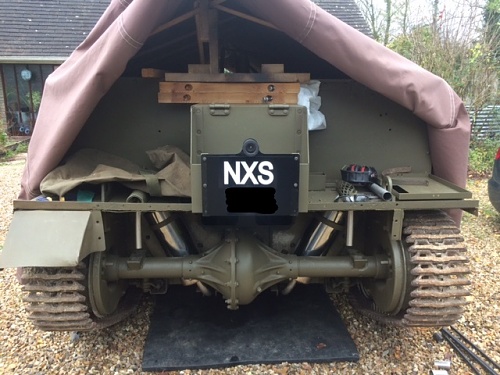

Good news; I have just completed the registration process for my Carrier and now have registration plates attached, so will soon be out on public roads! I've also made and fitted an exhaust system so I don't annoy the neighbors too much. All I need to do now is adjust the brake linkages as the foot brake doesn't actually stop the Carrier.
Also need to extend the exhaust downpipe as the length they currently are was matched from a photo of an 'Airborne' modified UK mortar Carrier, but my Canadian Carrier has welded brackets on the axle (for road springs?) which the exhaust dumps water into.
Tom

Tom, the lower cover screws are 3/8 BSF. The spring pads are there as a result of the fact that carrier axles were originally truck axles. I hope you aren't creating trouble for yourself with those sub calibre exhausts? The tail pipes should come down behind the axle?

Re the exhaust, what do you mean by sub-calibre? I've used 38mm pipe throughout, is that too small?

If it fits the various cast elbows on the exhaust system it shouldn't be

I've used 38mm from the cast elbows in the floor, through the whole system. The picture does make it look smaller than that though.
