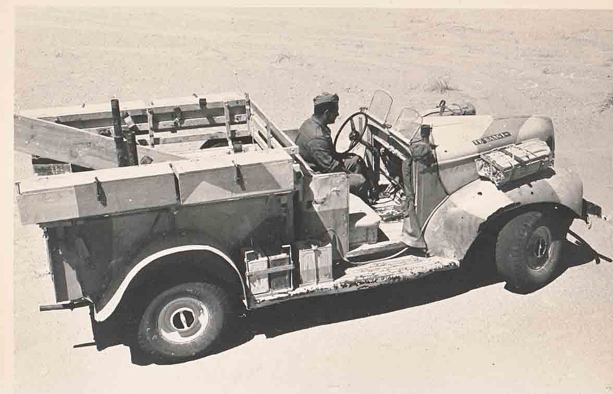

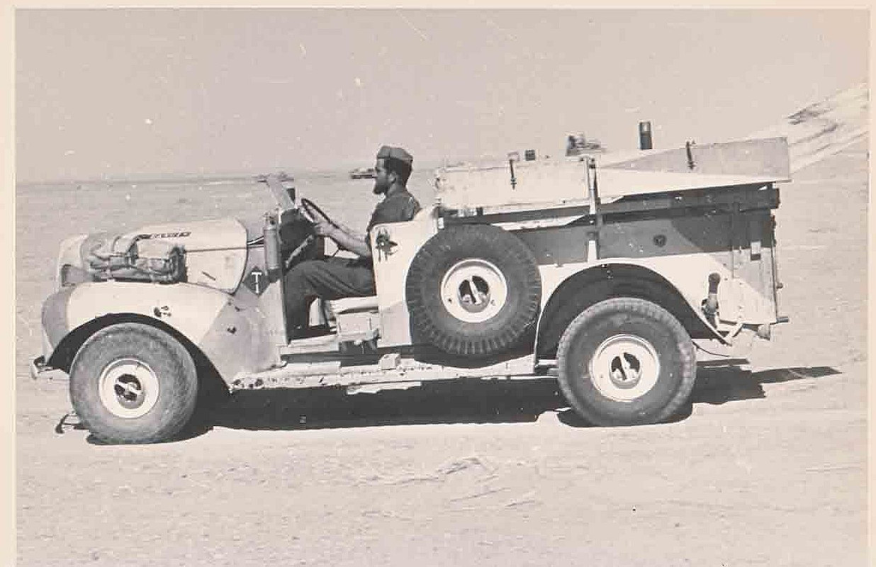

Hi Scott,
Two pics trawled from Ebay long ago, I hope you'll like them.
https://i.postimg.cc/Wb1P4Qhf/Ford-1...e-Rangi-p1.jpg
https://i.postimg.cc/tCvGn26R/Ford-1...e-Rangi-p2.jpg
Good luck with your build!

Old 11-01-21, 03:41
Originally Posted by Andrew H. View Post
What great photos!!
It is!
What is the rubber hose going from the engine bay to the POW can on the RH running board? Jury-rigged fuel supply? Radiator condensor tank?
Old 11-01-21, 19:12
Join Date: Feb 2016
Location: Bulgaria
Posts: 95
The hose diameter is small, IMHO it is fuel line.
Old 12-01-21, 08:16
Radiator overflow?
Old 12-01-21, 21:08
Join Date: Dec 2010
Location: New Zealand
Posts: 201
Most likely to be radiator overflow to condenser on running board.
Old 12-01-21, 23:24
Posts: 564
I strongly agree with Lynn and Andrew. To put the tank inside the engine compartment would have been difficult as there would not be much room and it would have got too hot in there for the near boiling water to cool. Similarly there would not really be space in front of the grill or on top of the fenders. The relatively small diameter pipe is necessary for the water to be able to suck back as the engine cools.

Old 13-01-21, 19:09
This could be a timing thing or the tank could have suffered an accident or a bullet hole?......
Old 14-01-21, 00:59
Scott Cacciamani Scott Cacciamani is offline
Join Date: Dec 2020
Location: Pennsylvania, USA
Posts: 80
Default overflow
I believe it is a overflow condenser for sure. Looks like the easiest way to mount one on that truck. Just great photos. just what i was hoping for.
thanks again
scott
Old 14-01-21, 03:25
This could be a timing thing ......
Could I also offer a suggestion that it could have something to do with the Vickers pintle mounted on the RH windscreen pillar? How early was this photo taken?

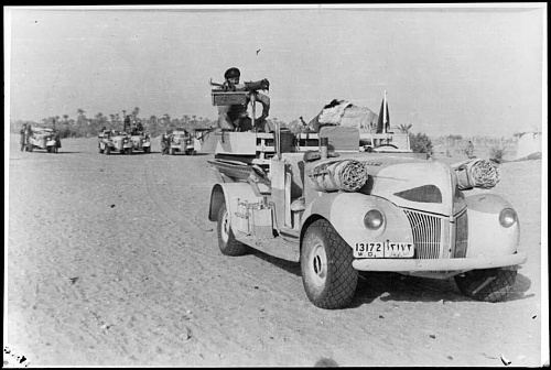

Old 14-01-21, 23:12
Posts: 14,911
More inspiration for your project:
“Long Range Desert Group (LRDG) column waiting for the surrender of Fort Traghen, Libya. Behind the machine gun is Lance Corporal Clarrie Roderick (Gisborne) who was later taken prisoner. Photograph taken on Fezzan Raid, January 1941 by Trooper F Jopling.”
Source: https://natlib.govt.nz/records/23053894

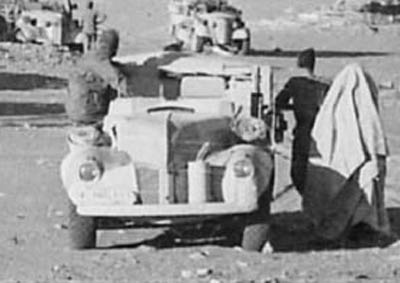

Old 15-01-21, 01:10
Vickers Gun, above the POW can with hose! But no Condensor on the front grille?
Hmm.
Old 15-01-21, 08:59
Join Date: Feb 2016
Location: Bulgaria
Posts: 95
Is it possible these cutouts in the bonnet were enough to keep the engine overheating away? On that one with condnser can I posted above they are missing...
