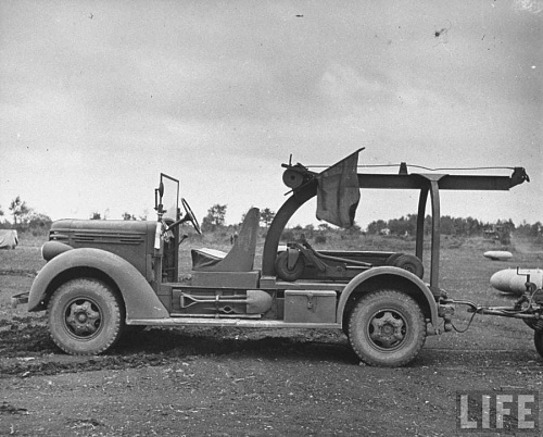

Hello! Does anyone know the details about this truck?

New photo. Now with tarpaulin.

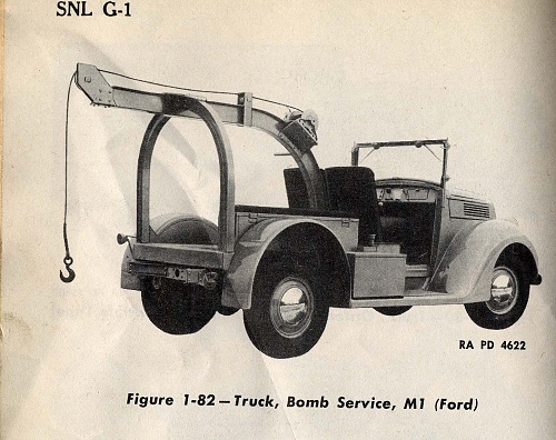

Now, this clearly isn’t a 4x4 chassis, but a 4x2. The “19-Y” denotes the Ford 1941 model-year 1-Ton Truck with 8-cyl 100hp engine and a 122" wb. chassis. “19-F” is an unknown designation but would denote a 1941 model truck. The subject picture shows a 1942 model front end, so clearly there was some evolution in Ford's 4x2 Bomb Truck while the Ordnance Dept. didn't amend their data. Anyway, to them it was known as an "M1 Bomb Service Truck (Ford)", of which a picture is attached (G85 M1 bomb service truck (Ford) with 1941 model front end - but it is not a 1˝-Ton, 4×4 truck).

Interestingly, S.N.L. G-1 lists two Ford Bomb Service trucks:
• G85, Bomb Service truck: M1 1˝-Ton, 4×4, Ford 19-Y
• G109 , M1 Bomb service Truck, Ford, model 19F

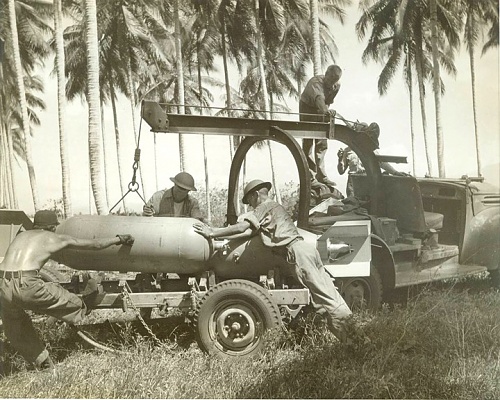

Default Ford M1 Bomb Service Truck on Guadalcanal
Here's another picture, courtesy of Military Vehicles Magazine which brought this topic back to top for me.
1942 caption: "For Tojo -- Bad News from Guadalcanal"
GUADALCANAL, SOLOMON ISLANDS -- With operational flights against Japanese ships and bases almost a daily affair, bomb loading crews of Marines on Guadalcanal airport are a busy lot. In this remarkable photo, bombs are being taken from "bomb gardens" concealed in palm trees, loaded on trailers and trundled onto the airport to be placed on U.S. Marine, Navy and Army bombers.

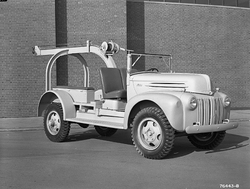

The photo with the number 76443-B in the lower right corner is a Ford model 11-T-S bomb service truck.

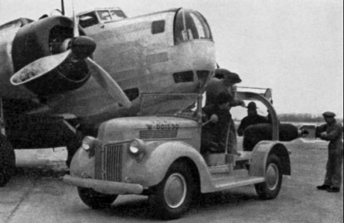

The similar looking Ford with the headlights mounted above the fenders rather than sunk into them is a Ford model 11-Y-S bomb service truck.
11-Y refers to a Ford 1941 model 8-cylinder 90-hp 122" w.b. 1 Ton Truck chassis. The -S probably refers to "Special"?
11-T refers to a Ford 1941 model 8-cylinder 90-hp 134" w.b. 1˝ Ton Truck. The -S probably refers to "Special"?
Of course this is a 1942 model, the designation for the same chassis in model year 1942 is 21-T. As said, clearly there was some evolution in Ford's 4x2 Bomb Truck while the Ordnance Dept. didn't amend their data. Interesting to see they opted for a beefed up chassis which could take ˝ Ton more.

Ford 11-Y-S (1941 model) M1 Bomb Service Truck delivering bombs to a Douglas B-18 Bolo:

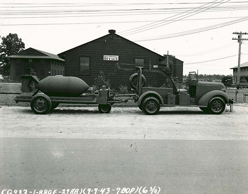

Page from Ordnance Pamphlet 865 Aviation Ordnance Equipment Catalog (1944).
