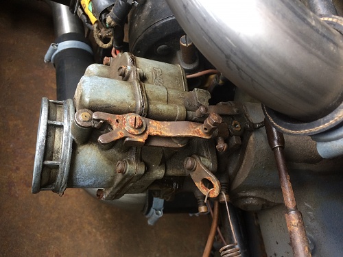

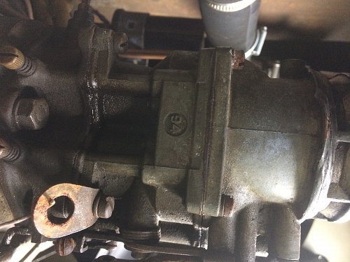

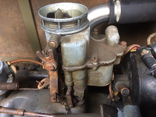

Hello to you all,
Can anyone identify this carburettor that’s fitted to my Mk1* Carrier? I don’t think it’s an original as it has ‘Ford USA’ on it and no sign of a governor.
Tom

It will be a Holley 94. Good article on them here: https://www.hotrod.com/articles/1104...the-holley-94/
They are alright carbs and kits are not hard to come by.

hello Tom,
it is a "normal" type 94 Ford carburator. It is the same type used as on Ford CMP trucks. This one is not a real truck one because the top were you put your aircleaner on is a little bit different. but it will do the job
gr Rob

Thank you Rob & Rob,
I will leave it as is then, it works which is the main thing. Good to know that there kits available for it as well as I think the injection pump may be failing as the engine tends to falter if the throttle is opened wide quickly.

Mac's has all the parts for these, including just the piston as well as minor rebuild kits.
I am running a truck carb on mine currently. It was not a problem adapting the carrier air cleaner tubing to the carb. I do have the original carrier carb, but as the old saying goes, if it aint broke, don't fix it.
