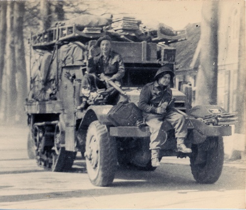

Old 19-04-21, 17:44
Posts: 14,934
As far as I can see this Polar Bears Half Track is carrying the bridging trays shown in this thread above.
It is one of a few photos taken during the liberation of Rheden, The Netherlands, on 16 April 1945.
