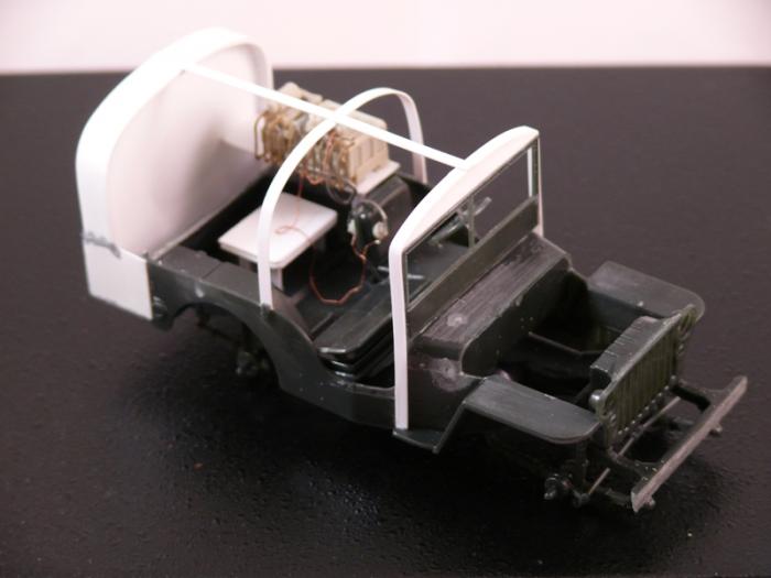

Default finished
Hereby some pics of the model "under construction" and the endresult.
Barry

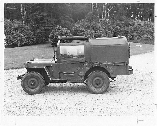

Old 15-05-21, 17:57
Posts: 14,944
And a side view:
Colin McGregor Stevens wrote:
"W-LU GOC_4th Canadian Armoured Division (Canadian Army PA211629_jpeg) This is the same jeep as in the colour photo above, just after it was customized for the General Officer Commanding 4 Canadian Armoured Division. They added roof, doors, flag staff and light and extension on rear of vehicle. It is carrying at least one wireless set."
