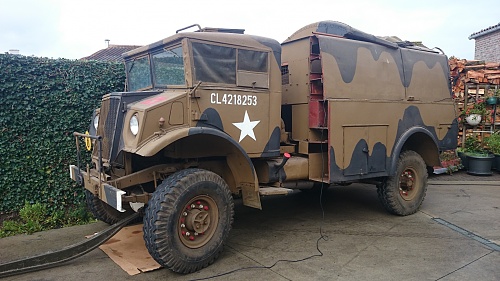

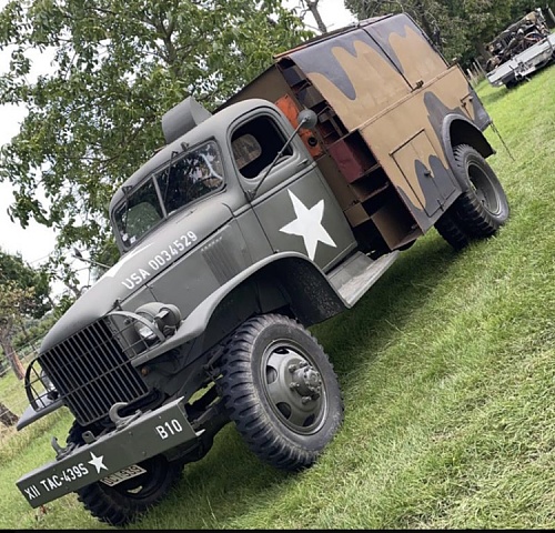

A long time ago, Johan Dieffenbach in Belgium fitted a US K42/K43 body on a C60S chassis:
Sometime after 2014, the body was transferred back into the Chevrolet 1.5-ton chassis/cab it came off originally:

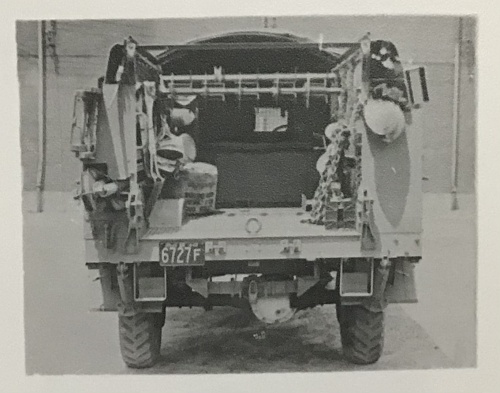

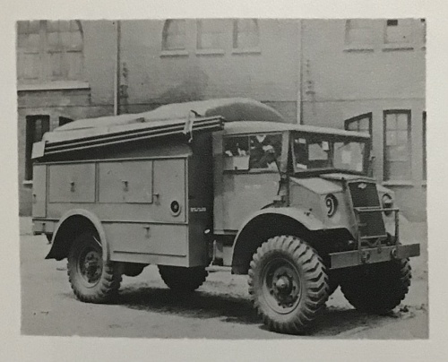

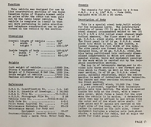

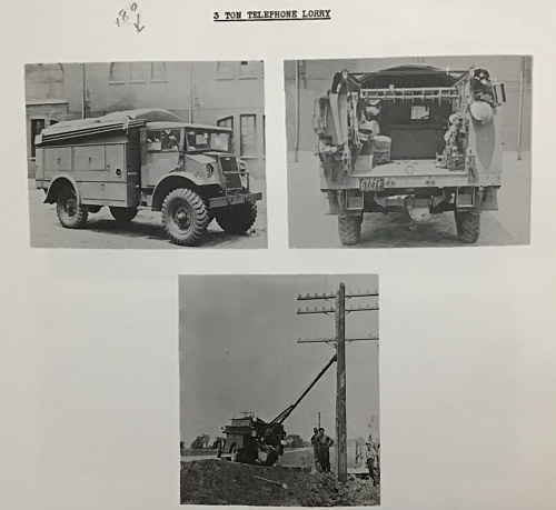

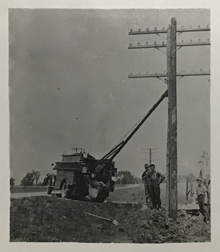

Hanno,
Here is the relevant info from Volume VI of the Design Record.
Thanks Colin!

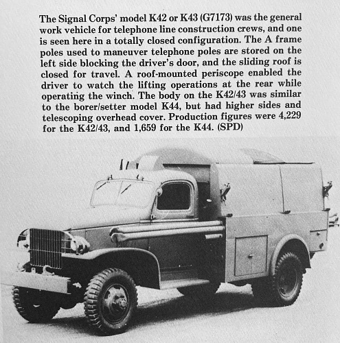

I also looked up the body type, the 4K1 was a "special steel Telephone (Signals Line Construction) body (...) similar to the standard commercial vehicles used for telephone construction work":
I also compared it with the body on the US Signal Corps' model K42 or K43 (G7173) which is of similar construction but shorter. So the Chevrolet C60S shown above as assembled by Mr Dieffenbach, was the result of some artistic license. That body was put back on the type of chassis it was originally fitted to.

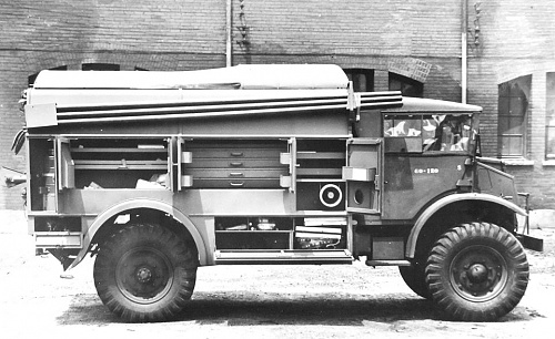

Some very nice period pictures can be found on the RCsigs website:
http://www.rcsigs.ca/index.php/CMP_L...l_Construction
Nice BIG maple leaf on the side and "Canada" written on the rear!
Very nice pictures indeed, thank for the addition!
I can understand why Mr Dieffenbach wanted to build a recreation of this interesting truck.
Source: http://www.rcsigs.ca/index.php/File:..._rightside.jpg
