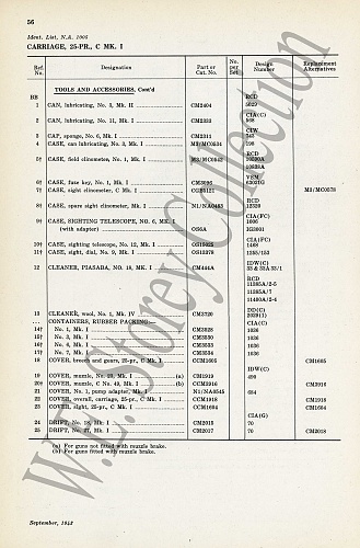

Attached is a page from the 1943 Parts List.
Name:	105. Parts List.jpg

Thanks Ed. Exactly what Mike was talking about. I wish I had the Cdn manual.....I have 2 guns, a spare carriage, a limber and 3/4, and a ton of EIS for the guns, but no Cdn manual. I don't get nuthin...
I did have some luck in that, since it is a balmy -4°C today, I cleared away some of the snow to the gun shed, pried the sliding door open, and discovered I have the no49 cover after all. It is likely post war as it is in green, and has no reflector, but it will have to do for now.
Any chance you can show the photo that goes with that part listing Ed? There are a few things on there that I am wondering about.
