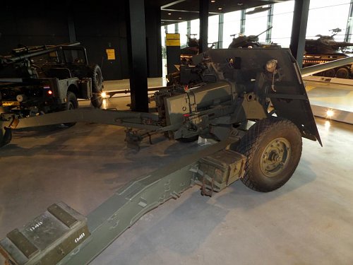

Chevrolet CGT FAT (ex-Danish Army) complete with limber and 25-pdr field gun.

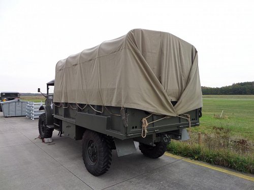

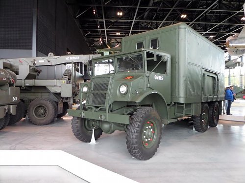

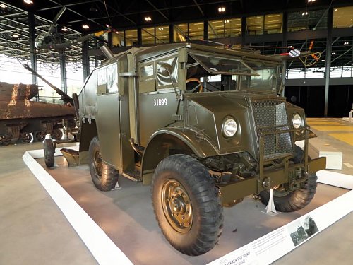

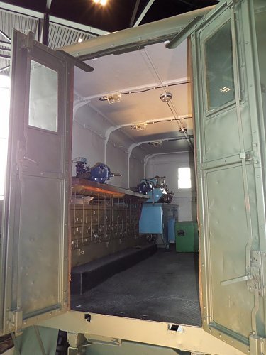

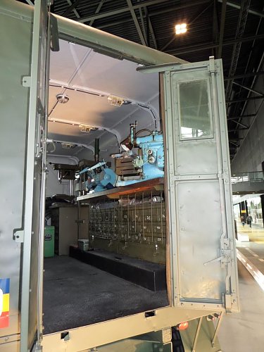

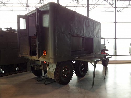

C60X 6x6, Machinery
ID:	76949 Click image for larger version
ID:	76951 Click image for larger version
Old 24-10-15, 22:35

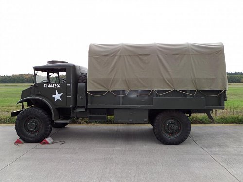

C60L APT, 4x4 3-ton truck
ID:	76954 Click image for larger version
ID:	76956 Click image for larger version

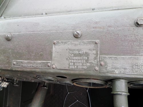

Build date July 30, 1945:

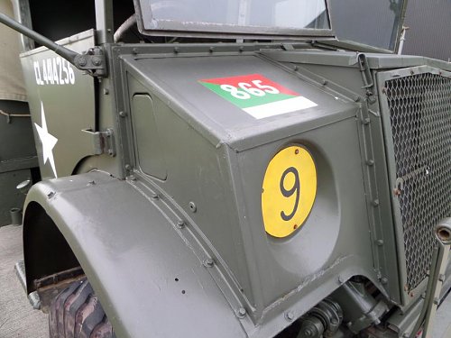

Detachable right-hand front quarter nose piece, typical for the APT (airportable) version of the C60L:

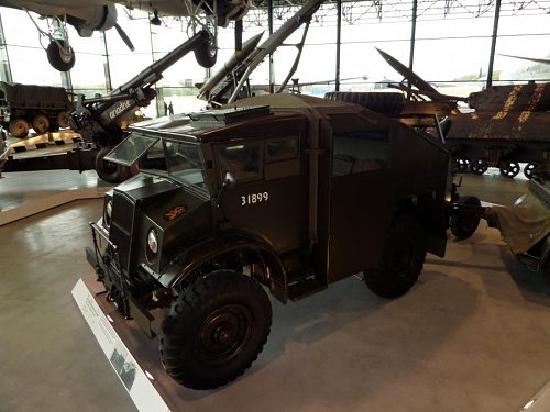

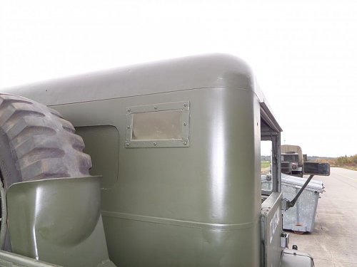

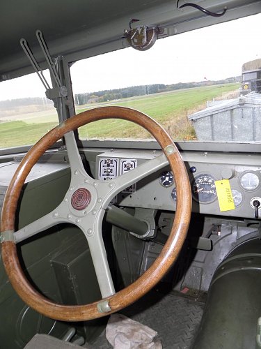

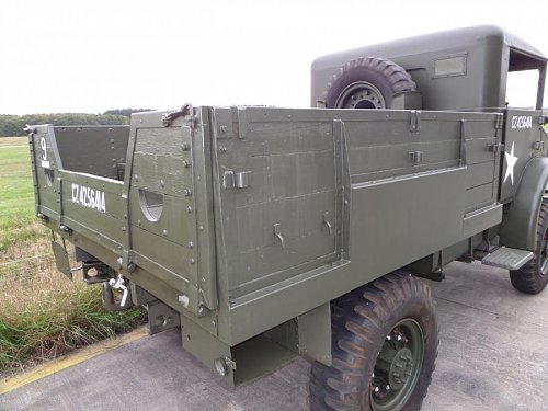

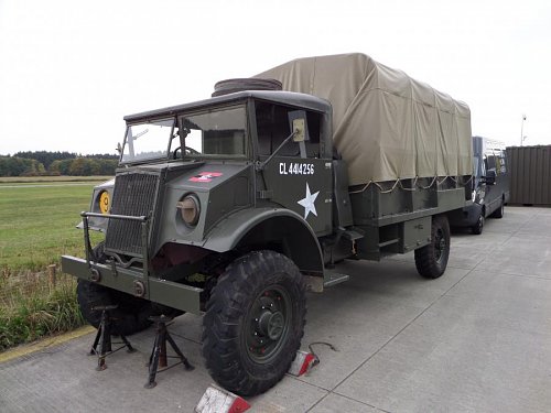

C15A, 4x4 truck with 2H1 composite wood and steel body
Note: both the C60L APT and C15A were recently repainted in Canadian livery by Bob Kos, with paint samples supplied by Alex van de Wetering, and parts supplied by Dirk Leegwater - all MLU members!
ID:	76959 Click image for larger version
ID:	76958 Click image for larger version
ID:	76960 Click image for larger version

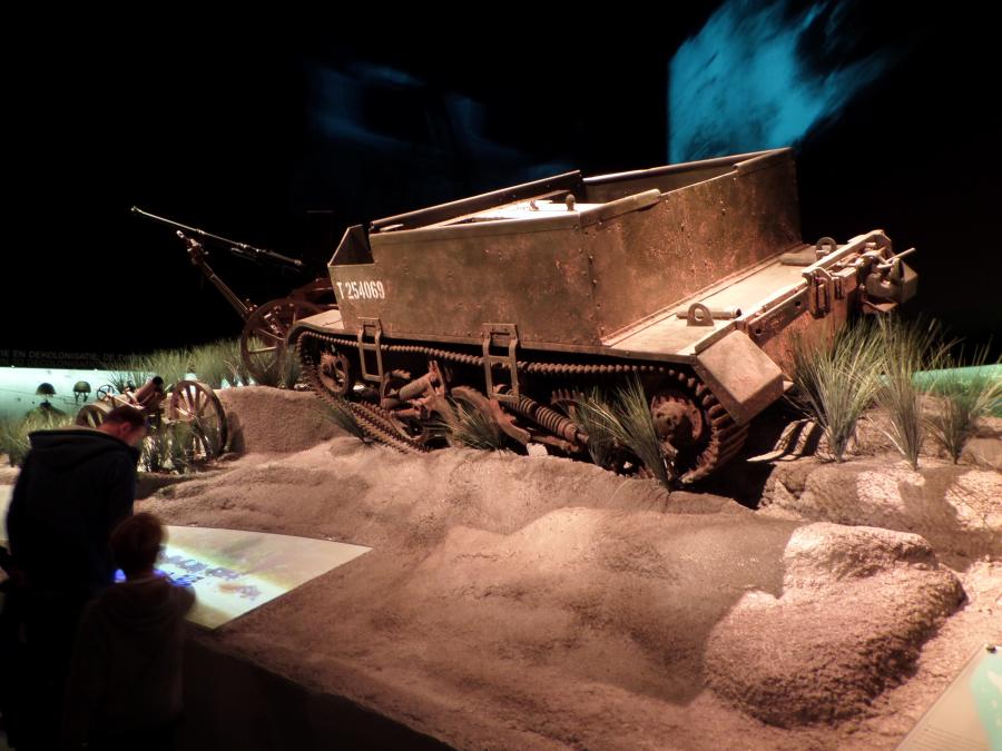

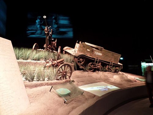

Universal Carrier, MK II (?)
ID:	76962 Click image for larger version

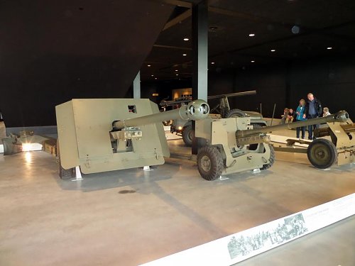

17-pdr and 6-pdr AT guns
ID:	76965 Click image for larger version

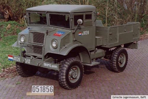

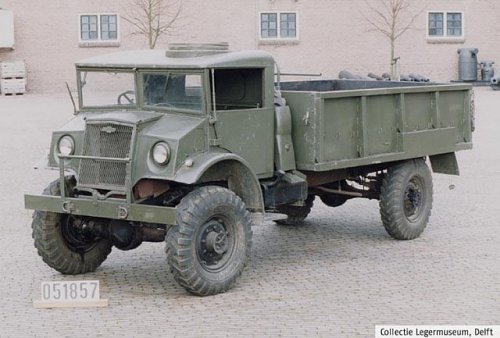

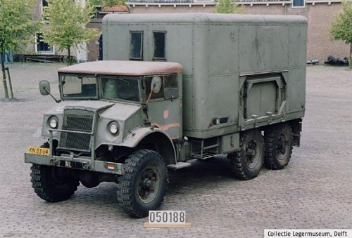

Some numbers on CMP trucks in Netherlands Army use:
  • About 900 C60L's in use until 1960
  • The Artillery had 165 CGT's plus 101 FGTs on strength
  • In 1951, 338 C15A's were listed on strength, but undoubtedly more were in service early after WW2
The museum catalog notes that the Army Museum acquired the C60L, C15A and CGT in 1975 as part of a major acquisition. They are unsure if these examples were ever used by the Netherlands Army.
The C60L was used in the movie "A Bridge Too Far".
The C60X was added to the collection in 1983, when it was in poor condition but came with Netherlands Army provenance. This type of truck was in use from 1945 until 1954, then kept is storage as war reserve.

Name:	wwwopac.exe%3Fthumbnail%3D%255C%255CBuffel%255Cimages%24%255Cvoertuigen%255C051856_003.jpg
ID:	76994 Click image for larger version

Old 26-10-15, 13:51
Hanno,
Did you take a picture of the Data plates in the C15A as well? The rear cab wall seems to be of a Wireless truck.

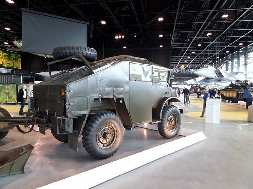

One CMP which is no longer on display in the new museum building is the Otter Light Reconnaissance Car.
In the Netherlands Army (RNLA) the Otter was used mainly for reconnaissance and driving courses. After replacing them by other vehicles, the RNLA transferred a number of Otters to the Royal Military Police (Koniklijke Marechaussee) which used them until 1970. The origin of this vehicle is unknown, but it did not serve in the RNLA.

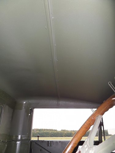

No data plates present, but it does have the aperture for the speaker tube in the back of the cab.
Is the lever with PTO (see separate thread) part of the Wireless Truck configuration?
It also does not have a roof hatch (or could this be a remanufactured roof?).
ID:	77011 Click image for larger version
ID:	77007 Click image for larger version
Old 26-10-15, 16:11
Posts: 2,323
The spare tire carrier behind the cab is not a feature of the Wire5 (the 2K1 body had the spare tire carrier set into the left side of the body). The generator(s) for the house type Wire5 were chorehorse(s) mounted in the right, rear corner of the body - not PTO driven. Based on these differences, if the truck is completely original and not an amalgam of features from a rebuild, I would guess it is not a Wire5. I've seen so many of the rear cab walls with speaking tube opening that I have wondered if they were used on vehicles other than wireless or if it is just that as a specialized variant the wireless remained in service longer than the GS? The C15A parts list doesn't list a separate roof assembly for the wireless version But it also doesn't list separate roofs for hatchless, square hatch and round hip ring variants - so there's no help there. The wireless trucks had extensive grounding to reduce interference. Check for short braided straps joining the parts of the cab. Also check for the shielded ignition system. According to the C15A-04 parts list, another identifying feature unique to the wireless trucks seems to be that the wireless trucks used a different rifle mounting clip system on the left side in the cab parts group 16.5791 and 16.580. I have never knowingly seen these to know what the differences are from the standard versions.
Hatchless roofs were a production item, my C60X hulk has one. Any time you are more concerned with weather protection than seeing out the roof they make perfect sense.The crosswise brace inside the hatchless roof looks to be an original pattern. I don't remember having seen the two braces in the curve of the roof above the doors. They aren't on my C60X but that doesn't mean they aren't original to the C15A shown.
Old 26-10-15, 16:44
Posts: 14,936
Agree with the WIRE-5, but what if it was a WIRE-1 / Fitted For Wireless (FFW) version, the one based on the standard 15-cwt cargo body?
Old 26-10-15, 17:03
Posts: 2,323
I agree that the tire carrier fits with Wire1 but think the chorehorse on the running board argues against the PTO driving a generator.
I also need to look at the information on the water tank body to see if it had PTO pump as well as hand pumps.
I don't think that PTO config. can be linked to wireless use. My bet is on a post-war mod, but I am curious if Grant can find out more about the water bowser.
By the way; Is the lever for the Transfer case missing? Or am I confusing things? That would mean it's permanently in two or 4 wheel drive(?).

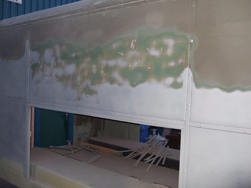

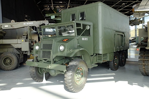

Default C60X Machinery

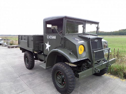

Martin IJdo of Historic Engineering wrote:
“We did a full restoration of this vehicle, carefully bringing it back to its full 50’s Dutch army livery including all the small details such as the indicator arms on the a pillar. Colour was exactly matched to a pristine part of the chassis behind the fuel tank. We were amazed to find that this vehicle had been completely stripped and repainted around that time.”
“Remains of shipping data on the side. Also the vivid green colour is clearly visible here, below the 70's layers of RAL6014.”
