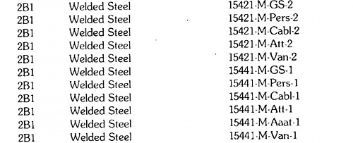

Hi Paul, the 2B1 body was used for various roles - see below. None of them carried a gun.

Sorry to ask, what are the various designations ie: M-GS, M-PER, M-CABL-2, M-Aaat1 etc etc and how did the beds differ?
