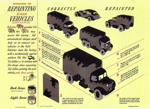

I'm also now looking at camouflage patterns, again I'm thinking early war era disruptive pattern green with black (tarmac).
Much of the information out there suggest all the upper surfaces, areas around the wheel arches and window were painted the darker colour (tarmac). But I'm not keen on all this black and I've seen period images (see below) that would suggest otherwise. I'd welcome any advice from you guys before I commit paint to metal.

It might make your life easier to know the cam patterns were in principle and not to be duplicated the same on every vehicle, so some some artistic license is possible. This is quite different that aircraft where the cam pattern was applied the same on ever Spitfire, Lancaster etc. using a uniform mask.

Funny thing about the original black & white photos, they can be a bit misleading. The 'dark tarmac' wasn't actually black.....if you look at tarmac roads/pavements in the UK (older ones) they are more a 'weathered grey'. The photo below was mixed from an original Dark Tarmac sample (the green is Khaki G3, for reference).

Default Mike Starmer’s books on camouflage
Paul,
Here is the most accurate description of paint schemes:
https://www.mafva.org/british-vehicl...flage-1939-45/
