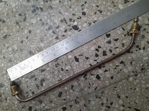

Default Pipe fuel pump to carb
Another NOS part found is this #9369 pipe, but to long for CMP flathead. May be for UC?
Attachment 132811
Hi Mariano,
It could be for the PCV valve equipped engines that use a spectacle plate below the carburettor to draw the crankcase fumes into the manifold.
The plate is about 1/4" thick so it raises the carburettor thereby increasing the length between the fuel pump and the carburettor.
Firsthand experience- I bent up one wrong length fuel line before I realised this!
