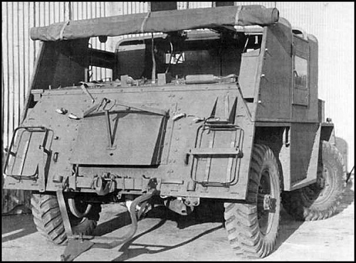

#2: The Command version had a queer-looking unarmoured (wood/canvas) rear upper structure:

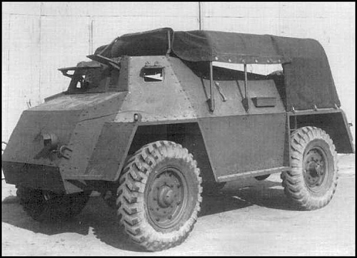

#3: Late Command car prototype with a side door:
ID:	104693 Click image for larger version

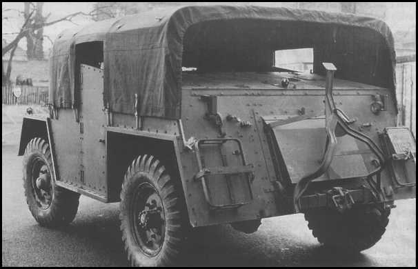

#4: The Duple-bodied Caplad from the rear. This variant also had a side door:
